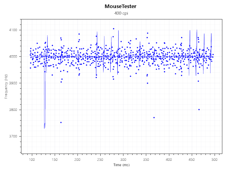

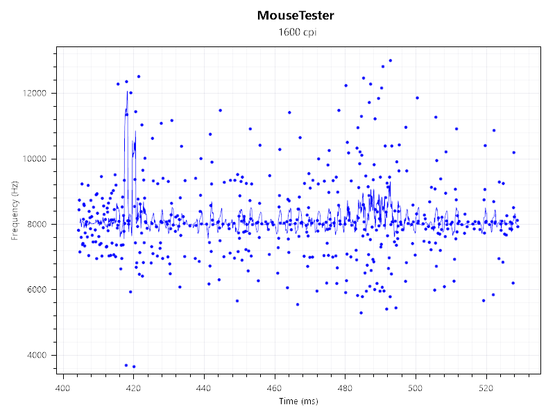

NEW SETUP : with the Razer Viper 8K mouse on the new PCIe Fresco Logic fl100ex chipset card & the Razer Huntsman Tournaments 1000hz
keyboard straight to the Asus TUF GAMING Z690-PLUS D4 Z690 motherboard on the 3.2. Gen 2 USB port.
4000 pollingrate 1600 DPI:
4000 pollingrate 1600 dpi alleen muis en keyboard muisoprodekaart.png (47.41 KiB) Viewed 40543 times
8000 pollingrate 1600 DPI:
8000 pollin grate 1600 dpi alleen muis onder op rode kaart keyboard boven.png
8000 pollin grate 1600 dpi alleen muis onder op rode kaart keyboard boven.png (50.87 KiB) Viewed 40543 times
I think the new setup looks pretty good especially with the 8k Pollingrate!! Now its time to give this setup a go! If u like to drop some feedback or advice: More then welcome! Tnx all! ( and tnx Chief especially! )
