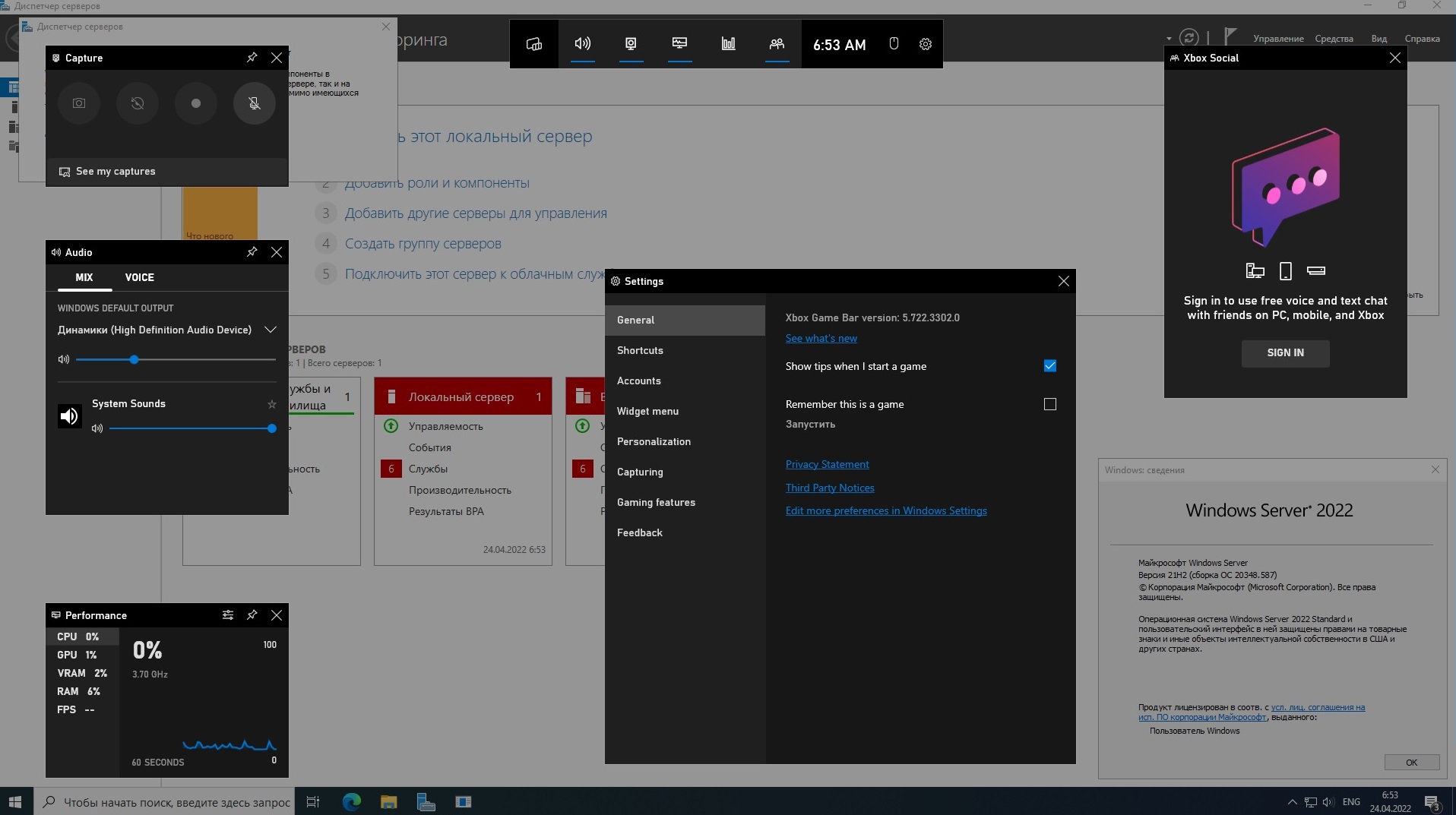

I am running Windows Server 2022 at the moment. I cant get Apex Legends to run on FSE. The GameConfigStore \ Children section is empty in my registry so I cannot put the "Flags" on 211. Windows Server 2022 does not have the Windows Store or a Gamebar. Is there any way that I can install the Gamebar without the Windows Store or a other trick to get Apex on FSE?
You can install the Windows Store https://drive.google.com/file/d/1l5g6uk ... sp=sharing . Gamebar needs to be checked.When I have more free time.

Post by 1000WATT » 23 Apr 2022, 23:34
daviddave1 wrote: ↑
22 Apr 2022, 17:38
Server2022 is missing gamemode and cannot install Media Feature Pack.
Gamebar starts, but not through hotkeys.
Without gamemode entries in the registry do not appear.

daviddave1 wrote: ↑
24 Apr 2022, 04:42
I couldn't do it with this method. But this is not the only method.
It is possible that another person will have more luck. ;)
