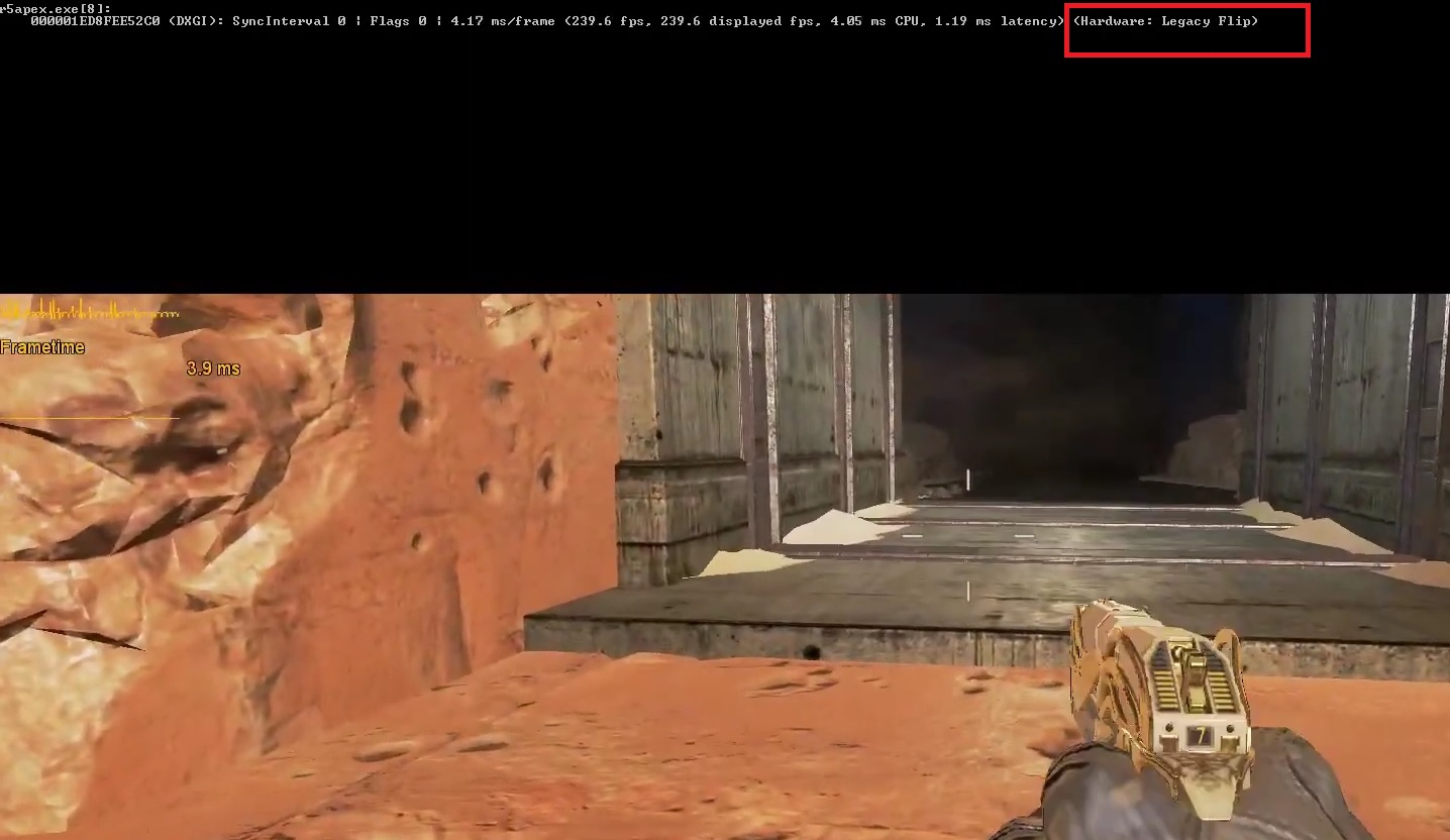

It seems I figured out what the omission is.
chenifa wrote: You said restoring the apex children folder via gamebar is key to enabling FSE.
Yes it is.
chenifa wrote: I asked if that actually gave you FSE back and you answered by linking a method to disable dwm.
Most likely it was this proposal that led to misunderstanding.
1000WATT wrote: I̶ ̶u̶s̶e̶d̶ ̶t̶h̶e̶ ̶a̶s̶s̶e̶m̶b̶l̶y̶ ̶s̶u̶g̶g̶e̶s̶t̶e̶d̶ ̶i̶n̶ ̶t̶h̶i̶s̶ ̶t̶h̶r̶e̶a̶d̶.
I used the build win10 suggested in this thread.
I suggested a build of Windows 10 available for everyone at the link. I have not suggested using the killdwm method.
Since this build is available to everyone and the fse mode for apex is available on it.
To avoid doubts, I recorded a video. Which shows that apex and other games are running in fse mode.

Np, but just reiterating, FSE was also working for me on several of the previous versions of Windows including v1909.
I understood why I couldn't run apex in fse mode before. Now everything has become clear. If part of the functionality of the game mode is cut, the system does not define apex as a game and an entry in the GameConfigStore \ Children section does not appear in the registry. If the functionality of the game mode is full, then the entry in the registry appears automatically, if this does not happen automatically for some reason, the game can be added manually through the game bar "remember as a game".
And only then you can make changes that lead to fse.
