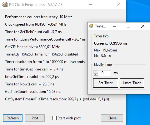

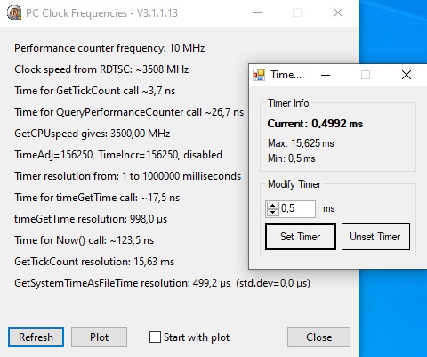

MatrixQW
Posts: 309
Joined: 07 Jan 2019, 10:01
Re: useplatformtick and/or disabledynamictick on mouse input lag
Post by MatrixQW » 24 Jun 2021, 16:29
forii wrote:
23 Jun 2021, 17:40
No need to force even number like 0.50ms timer resolution, there is no difference between 1ms~ or 0.5ms~, there can be with 16ms vs 1ms but mine was this 0.997ms by default.
Windows default is 15,625ms.
It's not necessary to change the timer because games (and multimedia apps) will do it and set it to 1ms.
Between 0.5 and 1ms there is indeed no difference as you can see in the screenshots, just a 0,0µs on std.dev for the more demanding. :)
