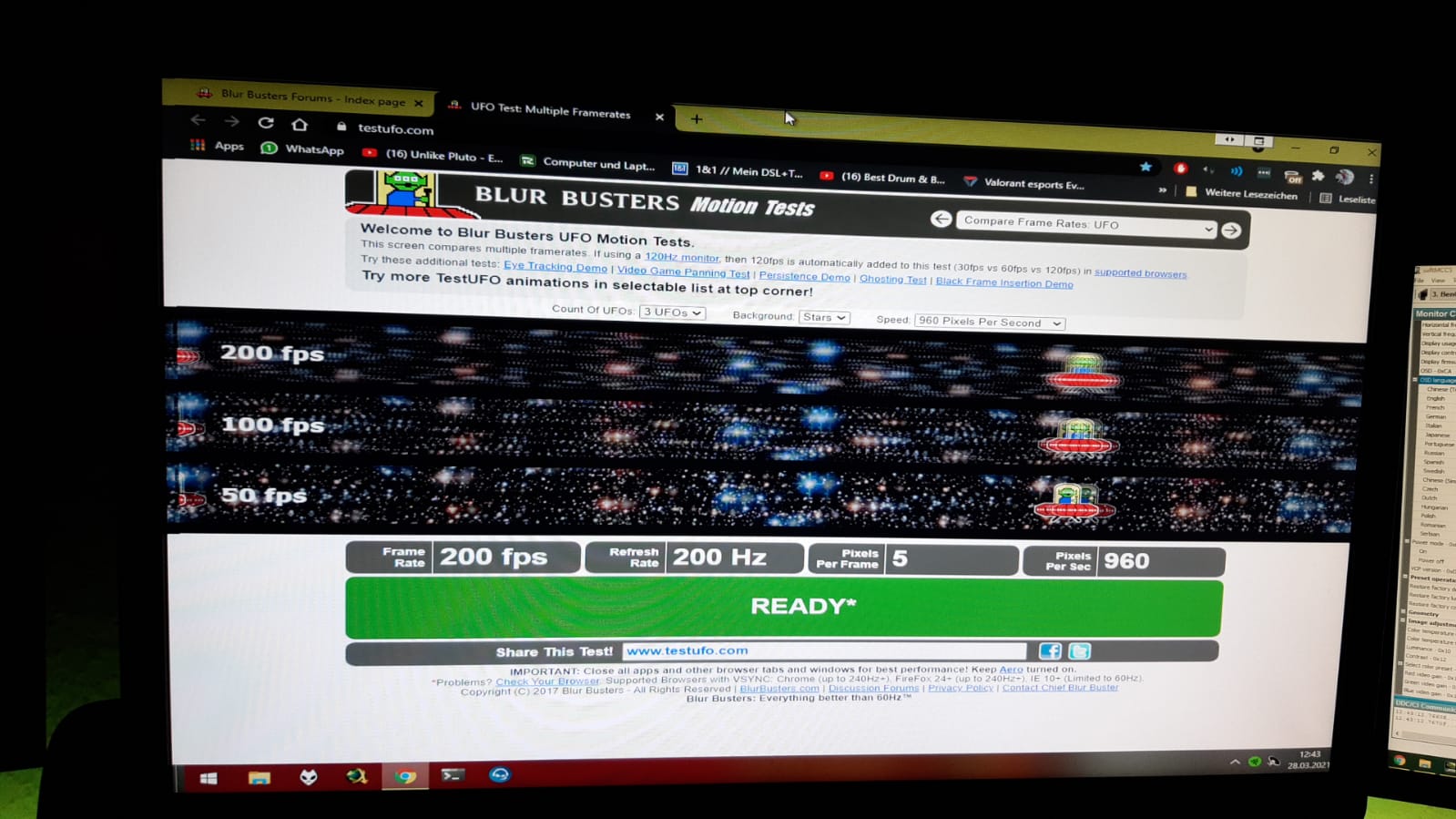

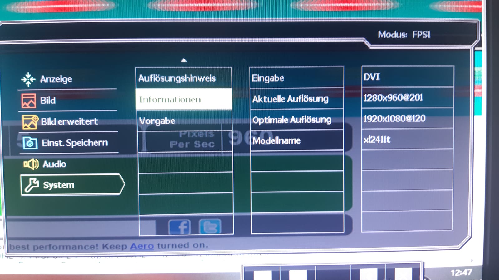

Posted: 28 Mar 2021, 09:40
by hELL1337
Hey guys.
i tryed every available version of OorBuster and AntiOutOfRange its simply that the Firmwarefunction is missing - or not available for this Monitor. maybe some1 good can figure a way out to fix that for us
@all who have a Benq XL2411T -i saw your posts on this thread that 0xDC is greyed out not clickable.
So the Trick wont work at our Monitors at least not with the use of the OoBuster tool.
dont forget to use the PixelClock Patcher
but u guys can install softMMC the workaround is almost the same.
Change Resolution and your desired Settings with CRU . The second monitor should be primary there u open SoftMMC .
set your reso on Moni 1 how want it. Then go in SoftMMC - do the Conformance Test - Read and klick through. some wrong answers could disable some more features. so be careful.
now simply activate the Language button "0xCC"
after this u can use hotkey ctrl+F10 or click the button in the header with the name "Restore Scaler Factory Defaults"
voilà u did it.
dont start to hard, but i could get 1440x1080 1280x960 1920x1079 @220 herz just need some fine tuning on VT and back porch.
but its not really the way to use it for gaming. and SoftMMC breaks easyli.
in attachments u find presets for CRU as import and some documentation
