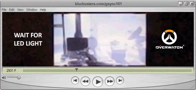

Did you fully read my test methodology?
https://blurbusters.com/gsync/gsync101- ... ettings/3/
I was using an LED connected to the mouse to determine when the click actually occurred, and then watching the display to see how much longer it took to actually reflect it on-screen:
