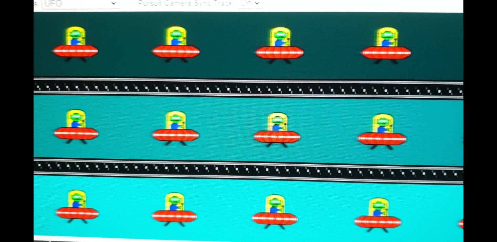

Are there any ufo shots of the xg2431 non strobed here? As it uses the same panel as aoc 24g2zu, it would be interesting to see how the raw performance of this panel is.

I tried to upload a video of the XG2431 without strobing but the site said file size is too big, so I decided to upload a shot from the video here. It's not really clear, but it's serviceable, and Freesync Premium and HDR would work with PureXP off, also it's brighter.
