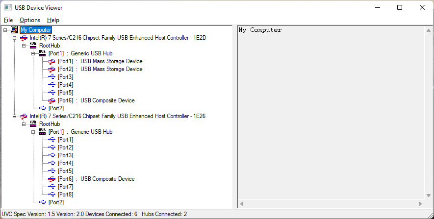

I came across a nice utility made by Guru3D member (the one who developed MSI utility) for this kind of subject discussed on this thread.
UsbView utility: https://forums.guru3d.com/threads/fresh ... ty.421820/
It looks like this:
You can see which devices are connected to different USB Hubs
