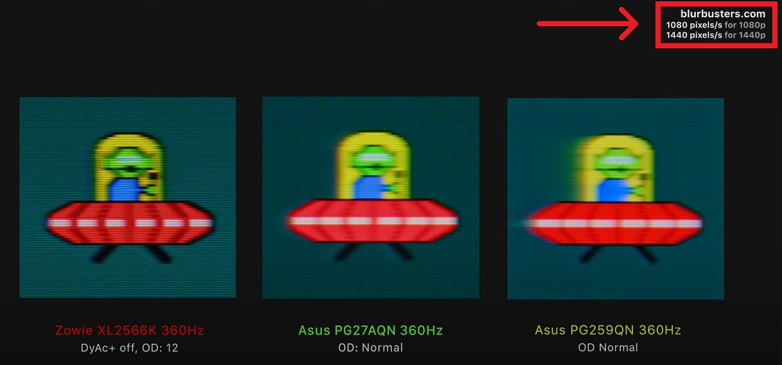

Optimum Tech has just published a review for this monitor!
Here is the TestUFO (compared to ZOWIE XL2566K and Asus PG259QN)
Testufo Asus PG27AQN
Bildschirmfoto 2022-11-06 um 17.24.30.png (1.48 MiB) Viewed 26214 times
Source: https://youtu.be/xDTWG_3edpo?t=316

He compared different movement speeds! Faster moving speeds will always look blurrier/smearer. So its not really a apples to apples comparison. Just something to keep in mind.
