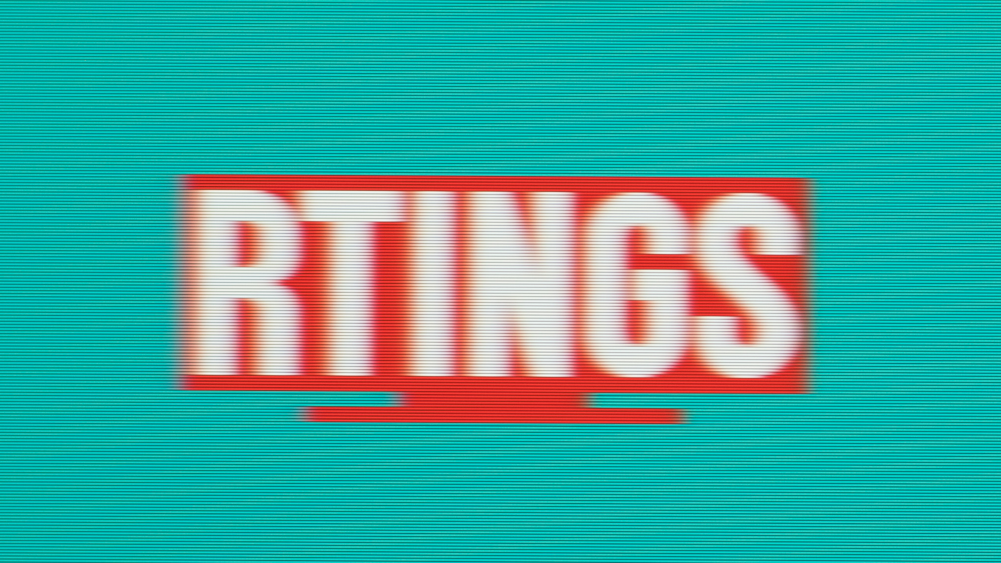

I want to share something I found in terms the overdrive behavior(again), it's not really a new thing but makes me wonder some things. Why does rtings recommend OD60 for 280HZ when OD40 has better response times with also no overshoot?
https://i.rtings.com/assets/pages/bM6yQ ... -large.jpg
What I notice too when I set the OD on 280Hz to 40 is that the input lag gets lower too, this makes sense as the better the response time is, the lower the input lag is. And when I set the shadow boost to 2 as recommended by axaro1 on other configurations, the response time gets even better and input lag lower.
Sorry I don't have a camera to proof this but you can see it clearly in the moving photo of Quebec city when switching between OD60 and OD40, that the OD40 has better clarity, look at the top building with the green roof for example when switching between OD60 and OD40.
I'm now using these settings that I described, OD40 280Hz and shadow boost 2, it gives very clear motion without overshoot and I'd like to hear from others experiences.

I don't own this monitor but it caught my attention because it has 0 overshoot whereas VG279QM has some (faster response time at the cost of overshoot).
Input lag is the time a picture takes to appear.
They are different things.
Try the UFO ghosting test and look at the two feet to see wich setting blurs the most.
The dark average is slightly better at OD40 but OD60 end% 60/80/100 is lower overall and that might translate into a better picture, wich seems to be the case with their logo.Anonymous125698 wrote: ↑17 Jan 2022, 01:55Why does rtings recommend OD60 for 280HZ when OD40 has better response times with also no overshoot?

Response time is the time it takes for a pixel to switch from one color to another. Causes blur. Lowering it won't change input lag time.What I notice too when I set the OD on 280Hz to 40 is that the input lag gets lower too, this makes sense as the better the response time is, the lower the input lag is.
Maybe it depends on the colors. The roof is smaller and has different colors. Their logo is clearer with OD60.Sorry I don't have a camera to proof this but you can see it clearly in the moving photo of Quebec city when switching between OD60 and OD40, that the OD40 has better clarity, look at the top building with the green roof for example when switching between OD60 and OD40.

Well on my unit the OD40 has better clarity compared to to OD60 and that's just how it is, maybe panel lottery. And when you lower the response time, it does decrease input lag, this is true as said by the guy in Hardware Unboxed channel who reviews all the monitors in their LG C1 48 inch OLED review, that "This oled competes with best lcds in terms of total input lag as transition times are lighting fast" the LG C1 48" oled has only 6ms of input lag where as the next fastest monitor on their list is the HP Omen 27" 240Hz TN panel. Soo yeah, lower response times mean lower input lag. And the whole picture is actually clearer, not just the roof.MatrixQW wrote: ↑17 Jan 2022, 14:43I don't own this monitor but it caught my attention because it has 0 overshoot whereas VG279QM has some (faster response time at the cost of overshoot).

And it also would help if you owned the monitor as this is the owners thread after all.
