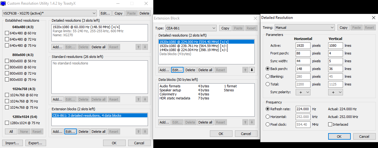

So what's the prefered way to create the custom 224hz resolution now?
CRU or Nvidia Control Panel and which settings to use?
Cru under CEA block because in NVCP created res you wont be able to set the 10bit color setting. I find nvcp has a bug where any custom resolution is jumping back to 8bit.
The gsync blackouts are fixed by raising the vrr limit to 55.
When i create it with CRU i still get 8bit over hdmi. Maybe i don't know how to use CRU correctly.
Maybe its HDMI, I use DP. Are you creating the resolution under CEA block? Because anything under custom resolution in NVCP bugs out the 10bit and downgrades to 8bit..NVIDIA should fix that issue tbh
Where do i go to apply it after i create it in CRU. When i go under display setting and check for hz on that monitor there is like 10 different ones and but the 224 that i apply is not the same as the one in CRU since the pixel clock is different. When i look in the monitor menu information i see 554hz and when i look under windows display settings i see 8bit.

Just click add, select LCD Native and change the refresh rate under frequency to 224 and that's it, leave all the timings default of LCD Native. Here is how it should look like afterwards.
