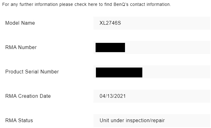

So my XL2746 started doing this:
I sent it in for repair to BenQ which was pretty painless via e-mail and fortunately the repair center is in California so it got to them within 2 days. Hopefully they fix it or send me a new unit. I'll update this thread once I find out more from them.

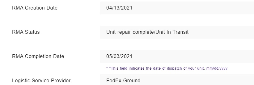

Well BenQ's website indicates they fixed it, if they did that was an incredibly fast turnaround and I hope they really did fix it:
