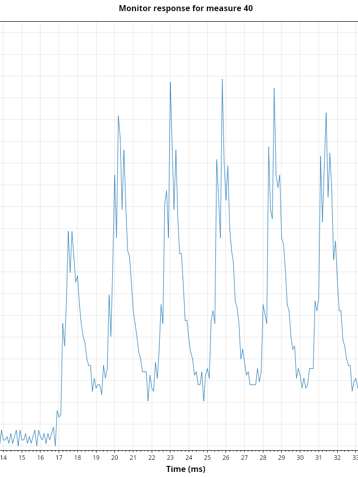

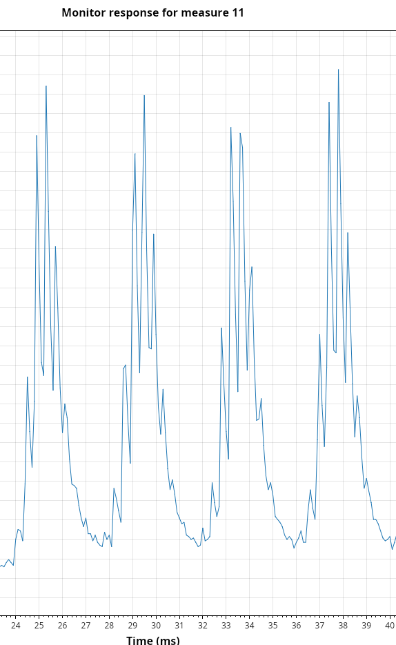

Went ahead and tested ULMB at 120, 240, and 360 as well just for fun
120
240
360
Not sure what's up with the graphs getting all spiky instead of one clean pulse as before. Possibly the individual "steps" of brightness as the roll goes by? (Assuming that the lossless adapter isn't the bottleneck... again, it's not exactly meant for this!). This could suggest that the 60hz implementation is indeed different than the higher refresh rate modes. My bet is still on it not rolling at 60hz. The clarity I see with my eyes, plus scan out skew disappearing in the 60hz strobe (yet present in 120+ ULMB & pulsar) seems to agree. When I flick my eyes, every pulse with the ulmb 60hz mode stays perfectly straight. The behavior matches what I have personally observed with OLED BFI, VR headsets, and Dyac screens which are all global strobes to my knowledge.
I also have a hunch that partially lit screen images in the 60hz mode is because of phones forcing variable frame rate videos. I don't know of any way to get an iphone to not record VFR. If I select 240fps, it mostly gives me random frame rates like 207.13 or 202.79 instead of 240. These videos will show partially lit screens that look like a roll, but a close to "true" 240 (239.97) video gives me 1 whole screen frame on, 3 full off frames in a repeating pattern as I posted before (or at least for a while until there's a slight desync as the 60hz mode says 59.94 in the display settings and I can't record at exactly 239.76). I would expect a 60hz roll filmed at 240 to have 4 frames of the scanout moving from top to bottom, but that never happens at 60hz on the pulsar monitor right now. Hope the tftcentral deep dive sheds some light on this once it goes public.
120
240
360

TFTCentral confirmed in their review that the 60 Hz ULMB mode is still using a rolling strobe (I won’t post the paywalled part here).
If you want to test it yourself for comparison, you could turn Pulsar and ULMB2 completely off and try ShaderBeam instead. ShaderBeam has settings for both global strobe and rolling scan emulation (you can switch by changing the Scan Direction parameter).
That way you could run the same measurement test on both modes and compare the graphs directly to what you’re seeing now.
Just a suggestion if you’re interested in getting your own data.

Dang... Im definitely surprised then. I wonder if it's doing something like rolling the backlight faster (i.e rolling at 360hz speed at the end of each 60hz interval?) cause it doesn't quite make sense to me how else it would roll at 60hz without noticeable artifacts. It's been a bit since I last tried ShaderBeam on my previous 240hz monitor but I recall the "jelly effect" with flicking my eyes being more pronounced than the 60hz ulmb. Might be interesting to take a measurement that way, but I'm also gonna trust the people that actually got the equipment and experience testing this stuff probably know more on the topic than I dobrownvim wrote: ↑18 Mar 2026, 05:33TFTCentral confirmed in their review that the 60 Hz ULMB mode is still using a rolling strobe (I won’t post the paywalled part here).
