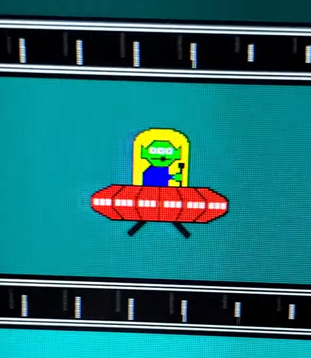

- Posts: 12306
Steering strictly ONLY to productive topics...Commentary Time!
Here's a curated framegrab, from careful freezeframe selection following Handwave Smartphone camera accuracy error margin best practices.
Acer Predator XB273X ULMB 144Hz (Zoomed framegrab of RLCSContender video, 99% quality JPG, preserving the original smartphone/YouTube compression artifacts)
Good capture. Though, I shake the "Angry Monkey Fist" at the YouTube's recompression/overcompression artifacts (annoyingly obscuring visibility of faint strobe crosstalk mostly below the noisefloor of compression artifacts).
As NVIDIA and Blur Busters has partnered on a few things in the past -- I'll have to send another recommendation that NVIDIA unlocks the strobe range (rather than just 3 or 4 refresh rates). Combined with other requirements for Blur Busters Approved, this probably would handidly pass the rigorous testing parameters of Blur Busters Approved. I wish we would see more monitors with unlocked strobe ranges, rather than hardcoded refresh rates.
Now, that said, ULMB does have a few hidden hacks available. One special request, does this monitor support the ULMB custom-Hz hacks (48Hz-155Hz), as well as the GSYNC+ULMB hacks? Could you run these hack-tests on this monitor? (If you're familiar with ToastyX Custom Resolution Utility)
<Pursuit Camera Commentary>
Alignment was sufficiently good enough (subpixel handwave tracking error over the duration of this specific particular selected freezeframe), that you actually captured the ULMB stroboscopic scrolling-screendoor effect (which only becomes visible at <1ms MPRT). While the sync track is still very slightly disjoint (less than 1 pixel error margin though), this is why I specifically chose this freezeframe; the compression artifacts were a bit less in this one, and the stroboscopic-scrolling-screendoor-effect actually was successfully captured.
Smartphone behaviour is slightly fighting against pursuit uniformity; the sideways rolling-scan sensor nature is visible (strobe-flicker bands, in bright/dark waves, like a flickering CRT tube recorded on video). When playing, you've got flicker-bands visible -- that's a widely known side effect of video-recording an impulsed display like CRTs and strobed screens. It's tricky to compensate, though diminishing visibility of this might be done by roughly doubling camera exposure length while halving ISO sensitivity (e.g. 1/120sec ISO 400 might become 1/60sec ISO 200), if you are using a SLR-adjustable camera app. Handwaves become much harder to find accurate freezeframes, but might erase part of those smartphone-auto-everything behaviours fighting against pursuit camera accuracy. Tough call; improved tracking accuracy versus improved integration (better simulation of human eye averaging behavior of multiple stacked refresh cycles)
Interesting Smartphone Camera Sensor Scanout Interaction Artifact
This freeframe of pursuit photo captured 2.5 refresh cycles, it looks like your smartphone only partially exposed 1 strobe (since the strobe turned off mid-camera-sensor-rolling-scan), an interaction between the global flash nature of strobe backlights, and the sequential rolling-scan nature of smartphone camera sensors. Since smartphone camera sensors are often recorded one pixel row at a time too, as a camera-sensor equivalent of display scanout behaviour (where an LCD refreshes 1 pixel row at a time sequentially). During portrait, your smartphone camera sensor is sideways-scan readout, exposed 3 strobes at left edge but only 2 strobes at right edge. Which explains why there's 3 tickmarks at left, and 2 tickmarks at right. So it's a less perfect emulation of human-eye refresh averaging behavior, creating brightness nonuniformities, but still fairly accurate WYSIWYG blur-wise (subject to capture chain flaws). Fortunately, it's not a huge error margin to WYSIWYG-ness of the resulting photo; the majority of the error-distortion is YouTube/smartphone camera compression artifacts; so this is still a validly-scientifically-analyzable pursuit camera photo (freezeframe grab from smartphone handwave video). Longer camera exposures per video frame compensates (1/36sec recommended for 144Hz with a 4-tickmark sync track) -- at the cost of increased difficulty finding good camera freezeframes.
Color adjustment job is better on this specific clip. Analysis is a bit easier on landscape videos, but handwave pursuits are easier with portrait phones (I prefer landscape.... But I prefer portrait pursuits with a few good freezeframes, over shakier landscape portraits with no good freezeframes)
</Pursuit Camera Commentary>
It's indeed an excellent ULMB tuning job. I jumped the 144Hz to the YouTube 1080p, freezeframed YouTube, and used YouTube "," and "." keyboard keys to single-framestep to reasonably good pursuit frames which exists at instantaneous points through the video.RLCScontender wrote: ↑21 Jun 2020, 00:20to start things off. ULMB for the acer predator xb273x. ULMB is only compatible @144hz, @120hz, and @100hz refresh rates. Unlike the MSI MAG251rx or the acer predator xb253qg x where you can strobe at 240hz, ULMB unfortunately can only go as high as 144hz for the g-sync 240hz predator.
