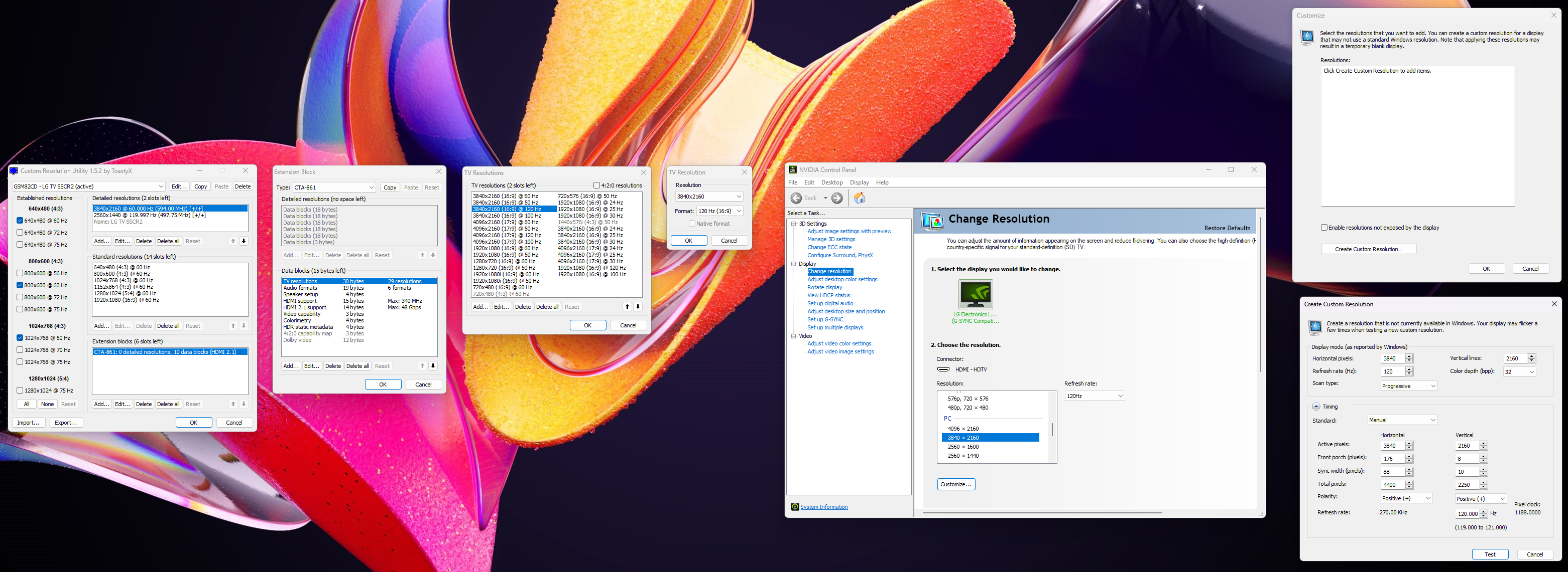

Have you tried this out? Either VT tweak or -10Hz tweak.
Unless I'm missing something obvious (I don't mess with custom resolutions much), then it doesn't look like I can (easily?) perform this on the LG C4:

jorimt wrote: ↑
11 Aug 2024, 09:56
Add a new 115Hz mode. Or 110. Then edit the freesync range from 40-120 to 40-110 (or 40-105 for 110Hz.) Make sure to not use the 120Hz mode for testing (I think you could just delete the 120Hz mode for the test to make sure it's not used.)
https://forums.guru3d.com/threads/fixin ... ys.450983/
If what I'm seeing on my end is correct, g-sync will appear to work just fine. All indicators of it working are there (OSD, hardware cursor update rate, g-sync indicator overlay,) but it just won't be actually working correctly and you'll be getting fixed refresh-like judder, just like with g-sync OFF. Like a 70FPS cap simply not being perfectly smooth.
I followed the Guru3D instructions to a T, applied the 115Hz res, and there's some very weird behavior:
  • Unlike the default 120Hz mode with G-SYNC enabled (where VRR only engages in-game, and the desktop is in fixed refresh rate mode), VRR is engaged, even on the Desktop, and my LG info shows a fluctuating 108.9~ Hz with a physical 115Hz refresh rate.
  • TestUFO shows 110Hz.
  • The TestUFO Frame Skipping test appears to be free of any actual frame skipping at this res.
  • I tried the VRR flicker test app, but it defaults to the highest refresh rate (120Hz), and I don't want to bother deleting it, since:
  • It still flickers during load screens/frametime spikes in-game (Cyberpunk), and I have confirmed it's at 115Hz (and fluctuating in the 108.9~ range).
In other words, while the custom resolution and manual FreeSync range appear to be working for me, it's not fixing the VRR flicker on my C4, which may further confirm this is heavily display-dependent and probably isn't doing what anyone hopes it's doing in the cases the VRR flicker does seem to be "fixed."
