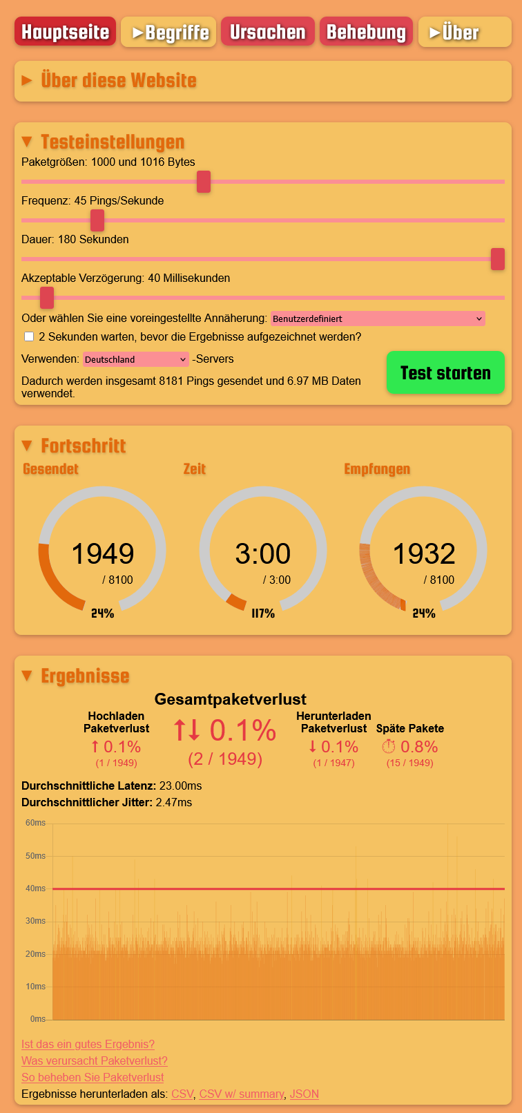

There is some hella weird stuff going on here. That result doesn't look right AT ALL. Something's terribly off. You've set the test in a way that it should send out 8181 packets. However, it only sent 4417? It shows it spent 111% of time, even though it's 3:00 out of 3:00? There's 4417 packets sent but only 4413 received, yet the result shows 0.0% loss? This is one hell of a result I've not seen before. I'm turbo giga mega hyper ultra surprised this doesn't show up in the game's diagnostic overlay somehow.

EDIT: This is what my packetloss test looks like. Yours should be similar to this. Image

What does the result look like when you select a different server, for example UK, and increase the maximum acceptable delay to, let's say, 50ms? It could be the server or the routing to the server, although I doubt it.

Also, please try a different server like the UK one, and also check the box "Wait 2 seconds before recording results". Report back if the result changes. There is a non-zero percent chance the routing is somehow messed up and that's what's causing the issue. Let's make sure it's not that before we move on to more time-consuming troubleshooting steps.

I think I've found the problem.
It's Firefox.
I ran Brave, Microsoft Edge, and Firefox side by side, and only Firefox was the test acting up.

LaggyTyp wrote: ↑
21 Jul 2025, 13:36
It's Firefox.
This does indeed look a lot better. A completely normal result without any anomalies and no packetloss. Perfect! This all but confirms, in my opinion, that there's nothing wrong with your internet connection. There's also nothing wrong with your NIC or your computer hardware. There were good hints that the internet was fine, because you didn't spot anything within the game's HUD that would indicate network problems, and these results all but confirm it.
