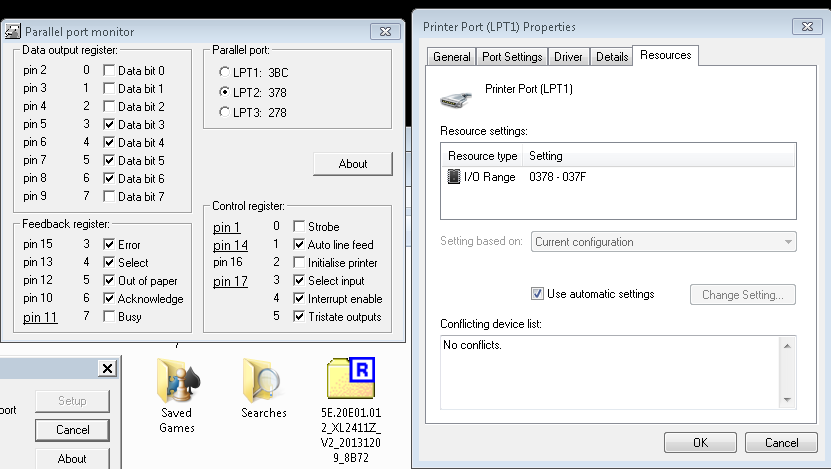

Find attached a copy of what LPT tool came up with - when clicking the different LPT ports the values change accordingly, but nothing changes regardless if the tool is there, isnt there or the program is 'connecting' or not.
pnum
Posts: 19
Joined: 03 Jan 2014, 02:13
Re: DIY Build ISP Questions [Build your own upgrader dongle!
Post by pnum » 22 Apr 2014, 00:30
if your adapter and LPT port are working correctly ticking the boxes for the 9 and 17 pins should change the values of the 11 and 15 pins

With the LPT test/parallel test tool, ticking any boxes immediately gets reverted back to when it is first loaded. The only buttons that change anything is selecting the port LPT1, 2 or 3 on the upper right corner.
Will be testing with 2 computers also - thanks for the help so far!
