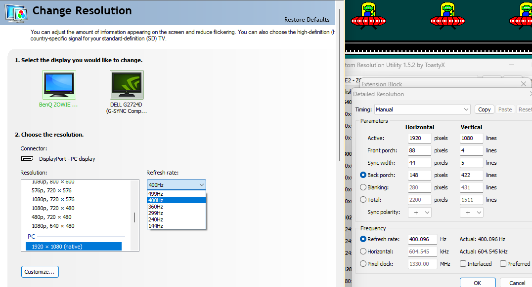

xl2586x 540hz, at 400hz, its the best ufo i ever seen, i also have pg248qp, rolling scan is much better on zowie, even though its slightly better than 540/500hz, i would still run 540/500hz, mouse just feels better
