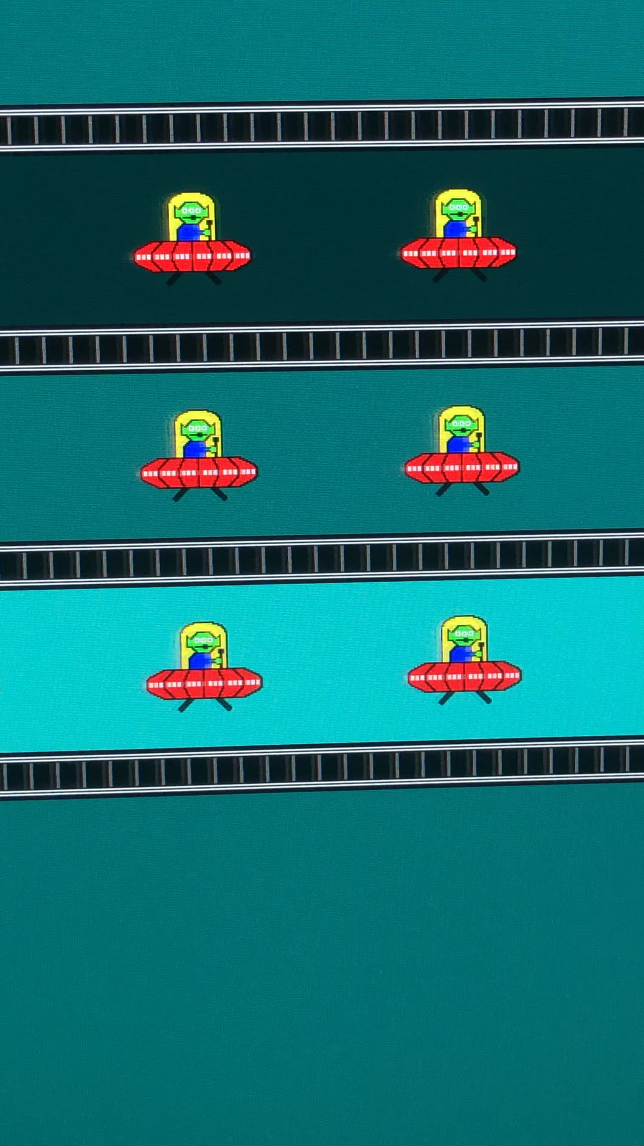

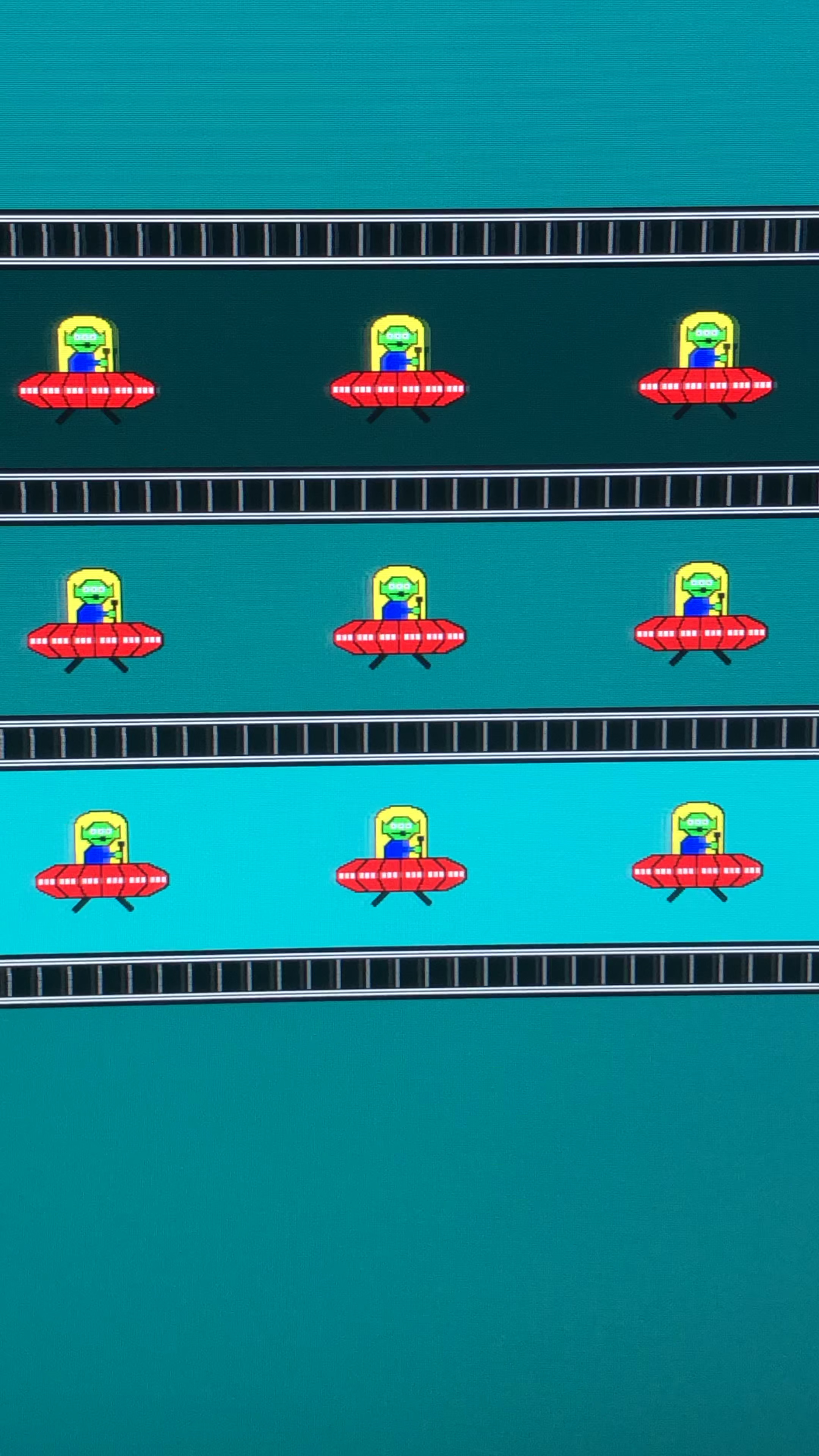

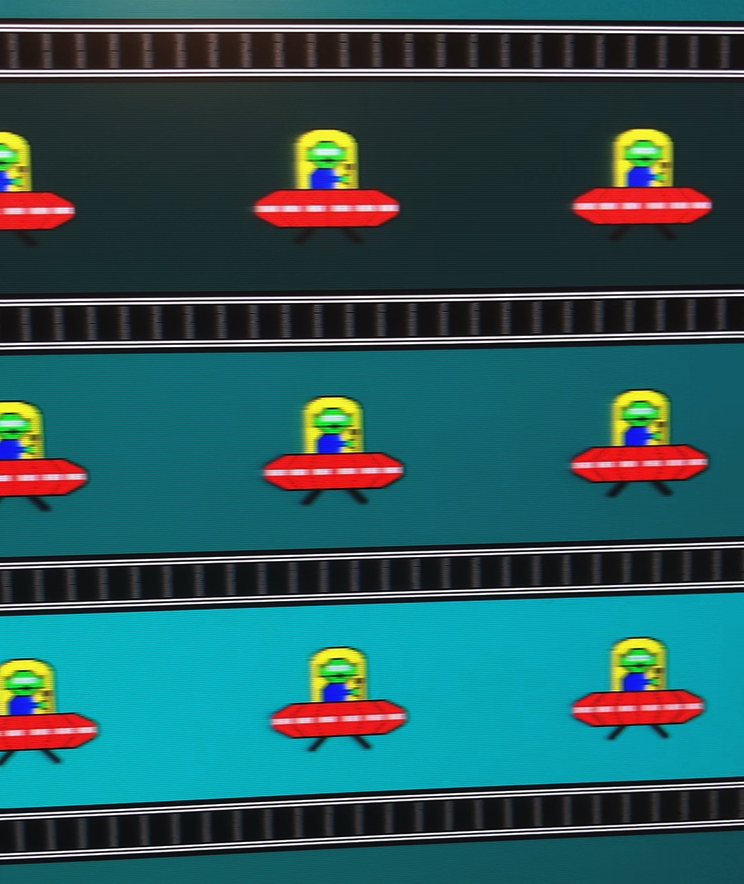

here are my pursuits at 240hz, 960pps. they're in the order of unstrobed ('ultra fast' overdrive), 'normal' pure xp, 'extreme' pure xp. my normal picture isn't perfect but I'd say it's reflective of real world use. shoutout to mark and discorz for some handholding.

I also took some shots of 60hz and 120hz QFT with custom pure xp tuning, which you can see here. as has been promised, 60hz is cross-talk free for the entire screen (ignore the bottom row, in reality it looks the same as the others). 120hz is also cross-talk free center screen with mild cross-talk in the upper and lower portions (again, ignore the one full column that has a shutter artifact). the testufo panning map at 2400pps was the most eye-catching demo of these QFT modes, with street names all being readable. I tuned the brightness here to be between the 'extreme' and 'ultra' presets.
my thoughts so far: out of the box 'native' colors seem natural. the 240hz unstrobed quality to me seems pretty good, and I can't detect any overshoot at the highest response time setting. the pure xp presets obviously take the motion clarity to another level. pure xp 'normal' is plenty bright for me, while 'extreme' is a touch too dim--but blur busters 2.0 means that I can custom tune an in between setting, though I've been too lazy to do so.
I don't have a lot of 60hz or 120hz content to test. on the fast scrolling sonic mania, I could see a difference in the clarity of text in motion. for the general art assets, though, I'm not sure I noticed a big change. the various blur busters testufo scenarios were impressive with the tuned strobing so they're clearly working as advertised.
at 240hz I'm not finding pure xp to be a night-and-day type difference. again, in-game text on the background signs in rocket league was sharper and easier to read while I flew past. in apex legends (arenas mostly), valorant, and overwatch I didn't feel any immediate difference. I also didn't perceive any increase in input lag when turning on pure xp modes. I've only been using pure xp 'normal' for the last few days so maybe I'll notice a difference after getting used to it. otherwise, maybe I'm more of a stare-at-crosshairs player than I realized and strobing won't benefit me as much in those titles.
for a long while I've been using 1440p screens (dell s2417dg 165hz, then alienware aw3418dw 120hz, back to s2417dg, then alienware aw2721d 240hz), almost always with frame-capped g-sync. the xg2431's resolution/ppi isn't as bad as the last 1080p monitor I tried, but it's still a very noticeable downgrade in resolution and screen space for desktop/browsing/non-game use. I think I've better acclimated to the lower in-game resolution. I use my other monitors for work, so the xg2431 would be a gaming-only monitor for me. my desk setup could support that without much issue, but there are still inconveniences like reassigning the 'primary' monitor in windows if I want to play certain games on a different monitor.
I've actually forced myself not to use my aw2721d while getting used to the xg2431 because I want to see if switching back has notable motion clarity differences and how much 1440p in-game matters to me. I definitely see the appeal for some people to use a 24" panel rather than a 27", but I put all of my monitors on arms and was comfortable viewing the 27" at ~75cm.
so I'm still deciding on if the xg2431 is a monitor I'll keep on my desk, but I've sure had fun playing with it. the strobe tuning utility/blur busters influence is something I'd happily pay a little more to get in a future monitor, and I'm glad to hear that blur busters is involved in some strobed vrr projects. throughout this process I've learned that I'm fairly sensitive to screen tearing, and I also appreciate the set-and-forget aspects of vrr. to that end: I've gotten so used to the osd joystick on my aw2721d that the buttons of the xg2431 feel like a big downgrade. at least the OSD itself includes on screen labels for what each button does.
[Edit -- crosspost to insert retro-friendly 60Hz QFT strobed pursuit that has zero strobe crosstalkImage
