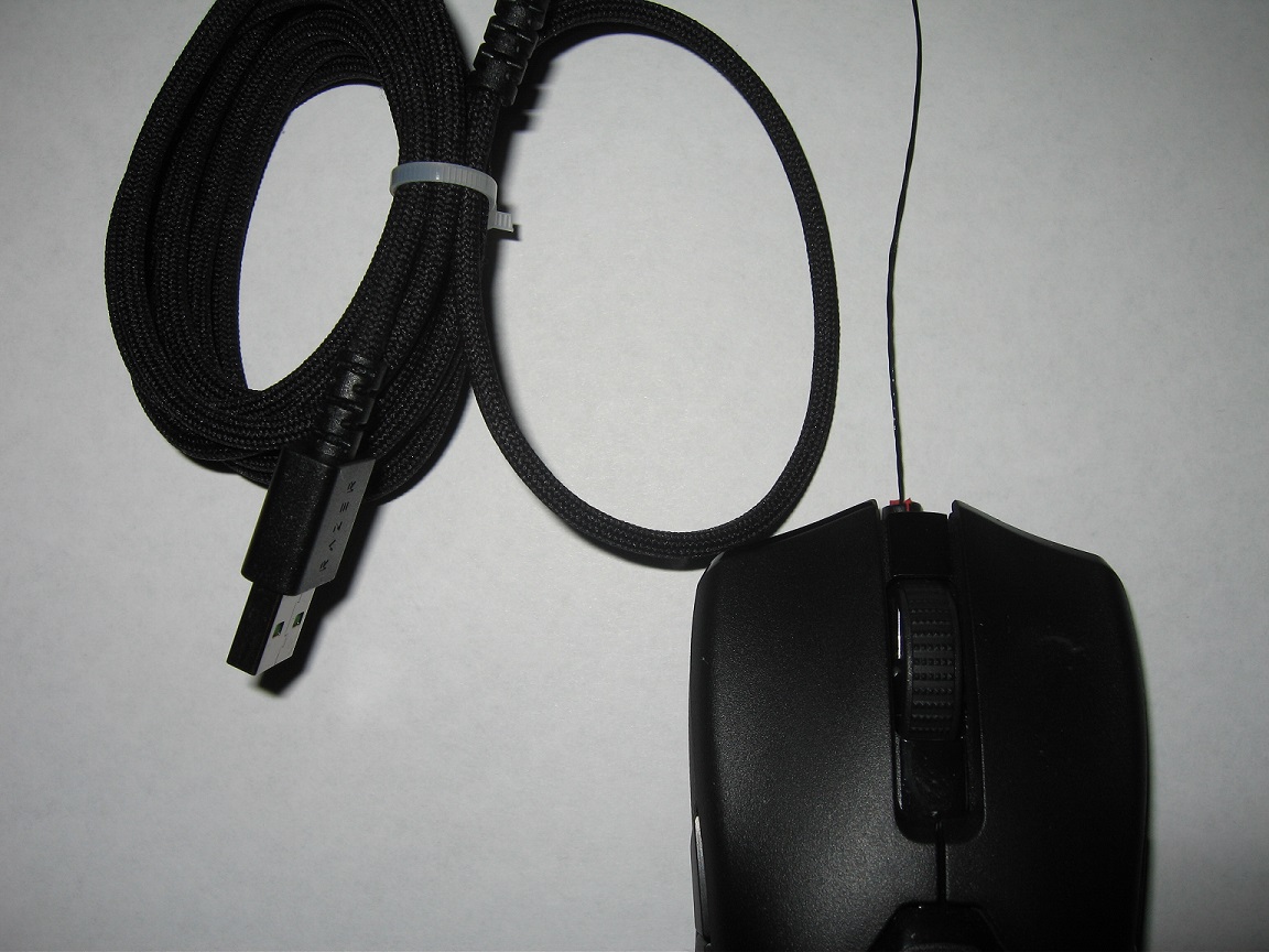

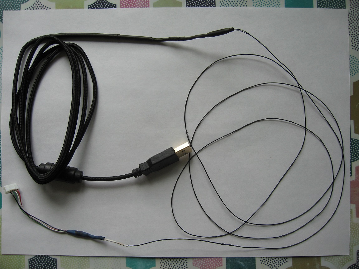

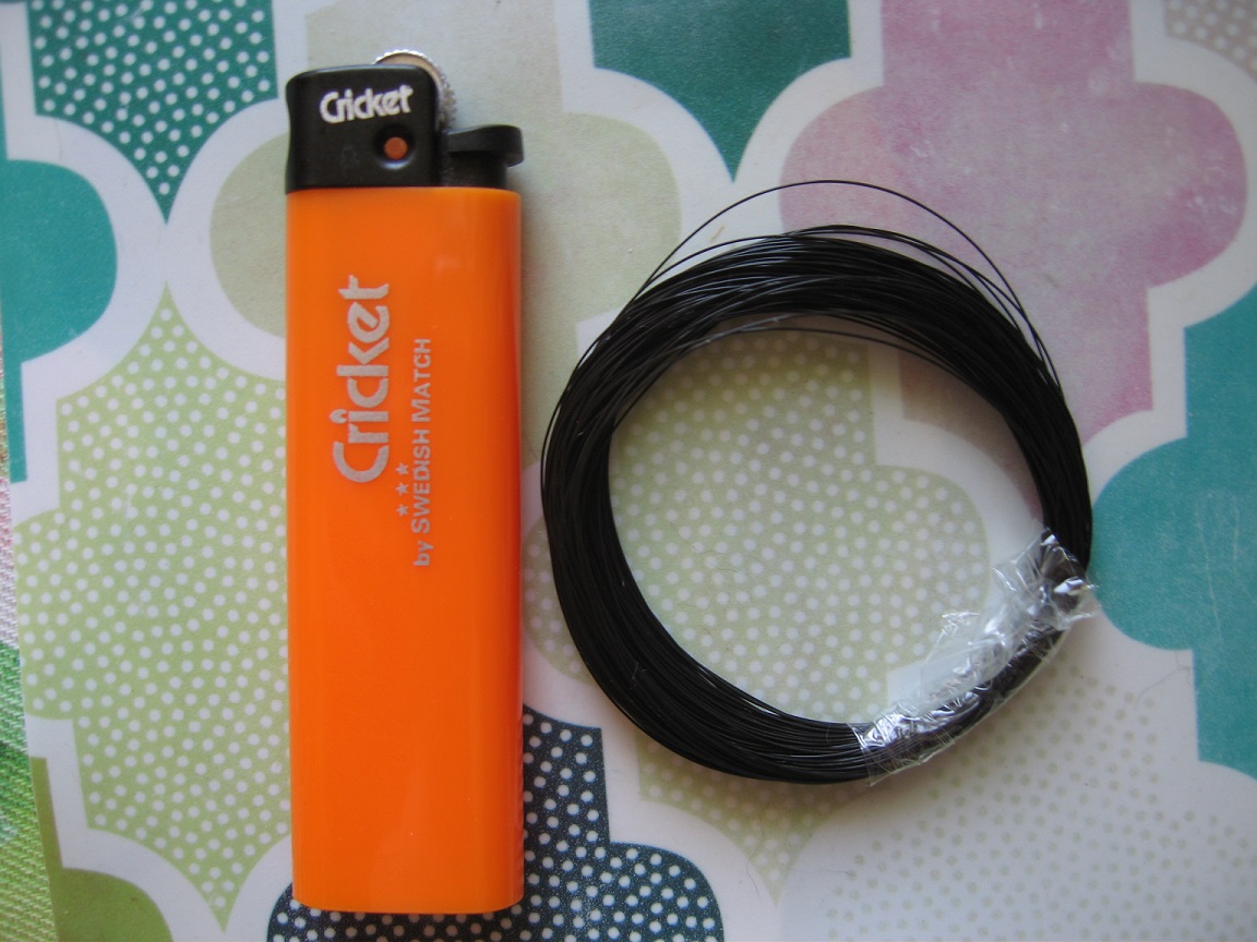

0,28 мм 7x0,05
Half of the wire is shielded.
