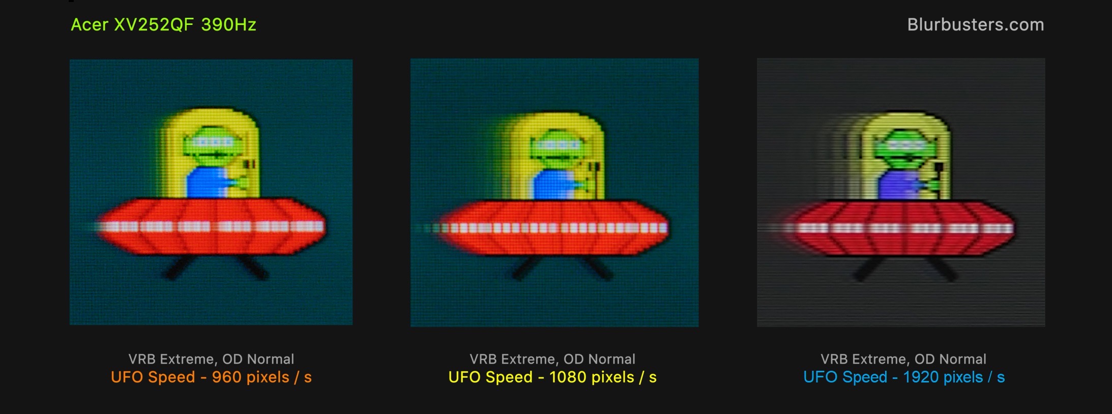

Pixel response time wise, yes! No doubts of it. I shown images some pages ago. On the left Acer Nitro 390hz, on the right ozone dsp24, both at 1080pps
If we talk about Strobing, to me it is even worse and no way I would play like this (I personally HATE trails and refuse to play with that). Acer Nitro 390hz max strobing:
something seems wrong with the image you posted of BFI. I'm watching the UFO on my monitor right now and it looks way better than the one shown... similar to DYAC+.
You can watch the comparasion on pretty much any review. No comparasion really imo
Honest question - why clip the 1080p/s ... it's clearly worst of the three. Both 960 and 1920 seem good.

These pursuits are taken by Optimum Tech. He is capturing only top row ufo with darker cyan shade where ips always looks a bit worse. His camera could use better setting adjustment with less exposure, details are lost in yellow ufo area. Ends up looking worse than it really is. The one with dark gray background is from Bijan Jamshidi, so its a different camera setup.
Here are some other examples:
viewtopic.php?p=68707#p68707
https://i.ibb.co/3kcJMLC/Acer-XV252-QF- ... 960psp.jpg
https://i.imgur.com/irnIPT2.jpeg
Beware that selecting speed presets on test ufo doesn't result to panning exactly at 960, 1080, 1920 pps. This can be tricky for direct comparison because slower speeds result is sharper image and faster in blurrier.
390Hz at 960pps actually moves at 780pps
360Hz at 960pps actually moves at 1080pps
240Hz at 960pps moves at 960pps
390Hz at 1080pps actually moves at 1170pps
360Hz at 1080pps moves at 1080pps
240Hz at 1080pps moves at 1200pps
All combinations here - Actual UFO Panning Speeds.
The thing is that.. it doesn´t matter. Because all of them seem rubbish to me and I refuse to play with that trail.. why would I if there are models without it? That´s my point
