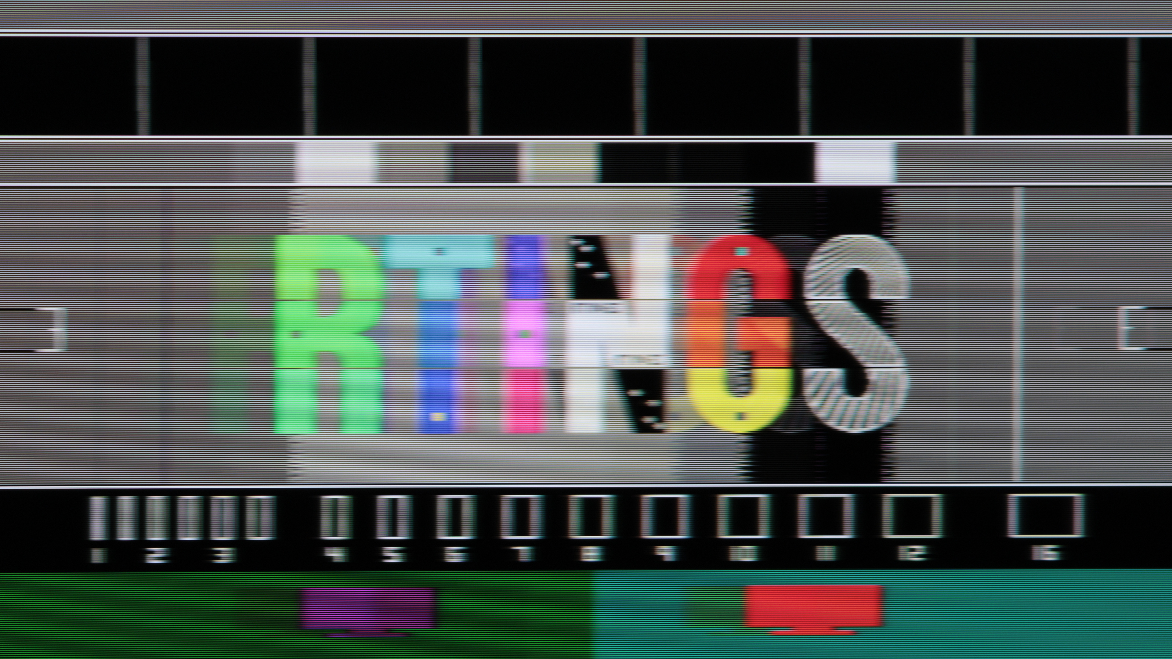

Okay SO - I have had the QN90D for a few weeks now and really put it through its paces. Here are my thoughts, for anyone who might at all still be interested in this.
I can confirm the motion clarity using strobing is excellent. Better than anything the CX could achieve, especially as you lower the brightness setting. With respect to motion clarity, I'd take the overall package of the QN90D over the CX any day - the flicker is less intense, the brightness (especially in SDR) is actually high enough to allow for the steep brightness losses required to get a 1-2msec MPRT over 60fps content, and the MPRT can go far lower. There is no detectable lag either with strobing, whereas the CX BFI I believe did add a meaningful, but not game-breaking, dollop of it.
HOWEVER
As the RTings review notes, the QN90D's strobing pattern does produce a slight image duplication. Sadly to my eyes this *is* noticeable in actual gameplay. especially on 2D content. This mars the motion clarity benefits somewhat - for example, scrolling 2D backgrounds ghost onto themselves, creating their own sort of smear that falls short of the LG CX/C1s perfect motion for slower moving objects. For 3D games and slower moving content, or when the colours in question do not contrast quite as much, the double image does become unnoticeable - and its an absolute treat when it does.

I just wanted to give a quick update to this topic that is near and dear to my heart.
RTINGS just dropped test results on the new flagship RGB Mini-LED TV R95H. I immediately had a look at the BFI test picture and, well, it's underwhelming.
Not terrible, still on the upper tier as far as TVs are concerned, but noticeably worse than their QN95 and QN90 models.
In general, CAD test results are pretty bad even by LCD standards, and it does seem to be a factor in how well the BFI mode performs (basically, even when the strobing itself is great, the pixel response time needs to be on the up and up otherwise it's not worth the brightness loss).
I have no reason to believe that this could be fixed by a software update, so I will wait for RGB Mini-LED to reach maturity, even if brightness and color volume does appear to be amazing.
Considering the high price tag, and the fact that, to me, there is no point to use LCD if strobing isn't CRT-competitive, I decided to pull the trigger on one of the remaining flagship Samsung QN95D from 2024 and fortunately got it at a decent price.
After analyzing the RTINGS review in details it's pretty clear it's the one I should have bought in the first place.
Basically, while the theoretical HDR brightness on the smallest windows is higher on the QN90D, and somewhat effectively in static tone mapped non-game HDR content, the QN95D outperforms it in many situations: higher zone count, brighter at 25-50% windows, and importantly for BFI, better CAD results.
I may keep my QN90D in another room, especially if no low-MPRT LCD TVs emerge for a few years and I need a backup, but it's pretty clear that I'll get better results in HDR gaming and as a CRT emulator with the QN95D.
I have a RTINGS membership so I am able to compare their results as needed.
I would still go for any available 2024 QN95D and QN90D model before they are completely gone. I don't like the matte coating on the 2025 QN90F, and it barely trades blows with its predecessors.
There are no QN90H or QN95H this year as the top-tier LCDs will be the RGB backilght R95 models from now on.
The Bravia 9 II review is not up yet, but given Sony's track record in recent years, I highly doubt its BFI mode will be worth a damn, let alone its MSRP.
I attached the R95H BFI test result for information purpose.
