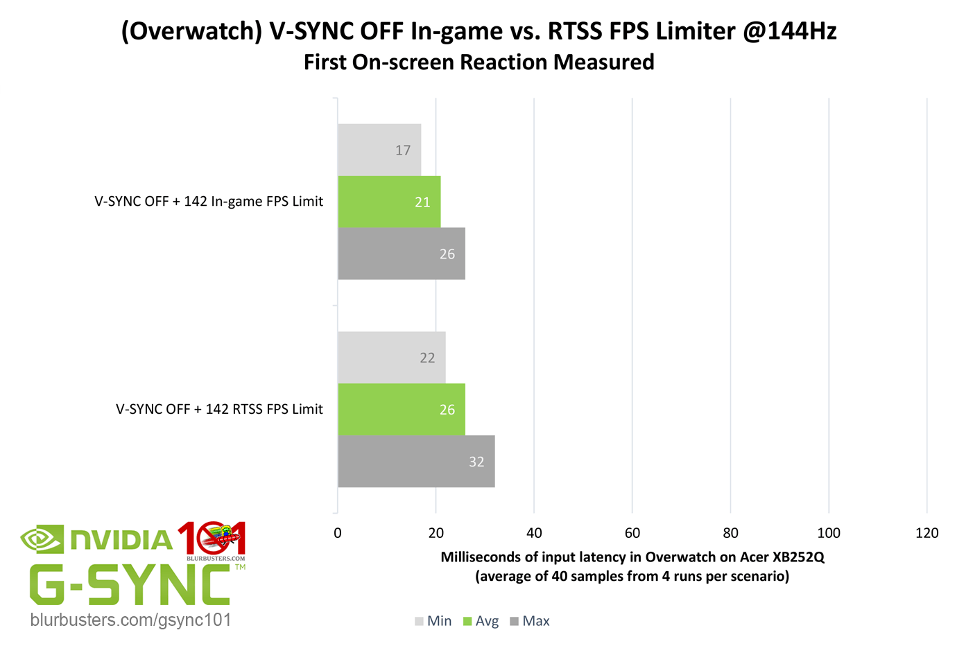

I'd be happy to amend "up to" to "less than" both in my article and in future references when discussing RTSS, but even I'm having a hard time wrapping my head around the concept.
For instance, how would we explain why RTSS sees higher latency with V-SYNC OFF than is seen with V-SYNC OFF + the in-game limiter with the same framerate limit, especially if what you say is the case?
The only way I could think to isolate and verify this is to run the game at settings that would force my system to sustain framerates below the given refresh rate, test, and then test RTSS at that same framerate.
(jorimt: /jor-uhm-tee/)
Posts: 4659
Post by RealNC » 23 Jun 2017, 11:39
jorimt wrote:I'd be happy to amend "up to" to "less than" both in my article and in future references when discussing RTSS, but even I'm having a hard time wrapping my head around the concept.
Because the in-game limiter can reduce the impact of frame latency on total input lag. At 100FPS, frame latency is 10ms. That is part of the total input lag. An in-game limiter however can remove some of that 10ms from the total latency, if the game renders at higher FPS.
Case 1: If the game needs 1ms (1000FPS) to render a frame, a in-game limiter 100FPS cap can potentially decrease total input lag by up to 9ms.
Case 2: If the game renders a frame in 10ms (100FPS), then a 100FPS in-game cap cannot reduce latency further.
RTSS on the other hand, will always behave as if the second case is always true. Regardless of whether the game renders the frame in 1ms or in 10ms, you will get the 10ms frame latency of 100FPS added to the total input lag. That latency is the same as if the game was running uncapped at 100FPS.
If you think about how external, non-predictive frame limiting is done (as RTSS does), it makes sense. The algorithm is quite simple. If the frame time is less than the target frame time (cap), wait until we reached the target frame time. That means regardless of how much time it took to render a frame, the result will always be the same as if the frame took Nms to render, where N is our target frame time. Thus, input lag is the same as if the game was rendering at the target frame rate.
In other words, RTSS is perfectly "neutral." It does not reduce nor increase latency. The in-game limiter reduces latency. (And NVidia's limiter increases latency.)
And, again, that's only "in theory". In practice, RTSS reduces latency in many games due to the frame buffering issue.
