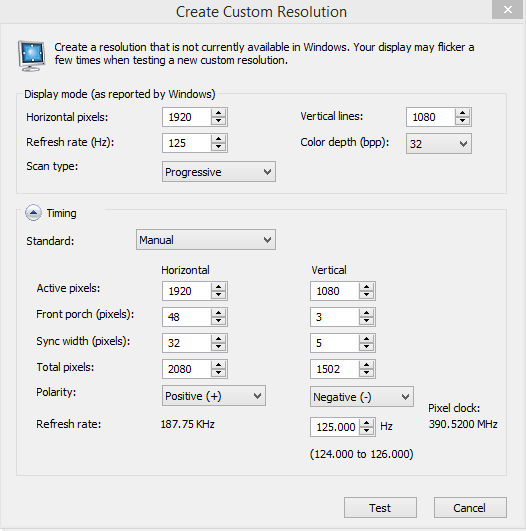

zefs
- Posts: 31
- Joined: 07 Oct 2014, 02:50
Re: XL2411Z V2, my findings so far [settings, VT1500 trick,
Is it normal that I get out of range on my XL2411z v2 when trying over 1350VT @ 120hz?
Also what's the point of using that instead of 144hz without VT tweak? (since they have same pixel clock, 356.40 mhz) is it about motion will be smoother if my GPU produces closer fps to 120?
With custom resolution in nvidia control panel I can get 1502 and apply it as resolution and it works but in Toasty it gets out of range.
What am I doing wrong?
- masterotaku
- Posts: 437
- Joined: 20 Dec 2013, 04:01
It depends. There are some VT ranges that give out of range errors. Like 1400VT, I think. Jumping to 1500VT solves it.zefs wrote:Is it normal that I get out of range on my XL2411z v2 when trying over 1350VT @ 120hz?
With blur reduction, you'll get a lot more crosstalk at 144Hz than at 120Hz with the VT tweak. Without blur reduction, 144Hz is better.zefs wrote:Also what's the point of using that instead of 144hz without VT tweak? (since they have same pixel clock, 356.40 mhz) is it about motion will be smoother if my GPU produces closer fps to 120?
If it works in the Nvidia CP, save that resolution there and don't do it in ToastyX CRU. It isn't necessary. You're probably using different timings apart from the VT.zefs wrote:With custom resolution in nvidia control panel I can get 1502 and apply it as resolution and it works but in Toasty it gets out of range.

zefs
- Posts: 31
Here's my settings, it seems to work since if I apply the default resolution (1920x1080 @ 144hz) which is listed in the list there is a difference in brightness. Are those the values you are using as well? I hope there's no issue using these settings for 24/7 usage?
