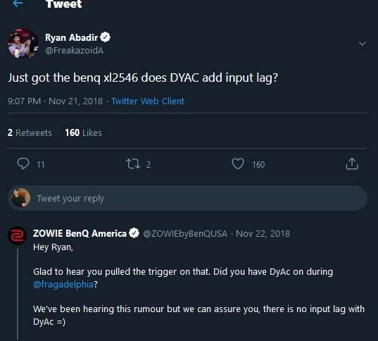

Question for Chief Blur Buster, could this be considered false advertisement and open up BenQ to a lawsuit? They claim DyAc has no input latency but we all know that's not true of BFI:
