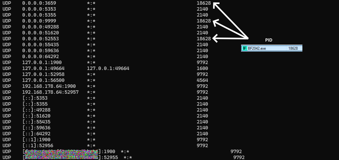

Wireshark > Filter > udp.port == 3659 > No entries
File is ~15Mb
Re: No FPS gaming possible
Posted: 23 Jul 2025, 05:46
by LaggyTyp
Screenshot (27).png (73.56 KiB) Viewed 1465 times
Filter:
udp.port == 3659
udp.port == 9999
udp.port == 52553
No entries :?: :?: :?:

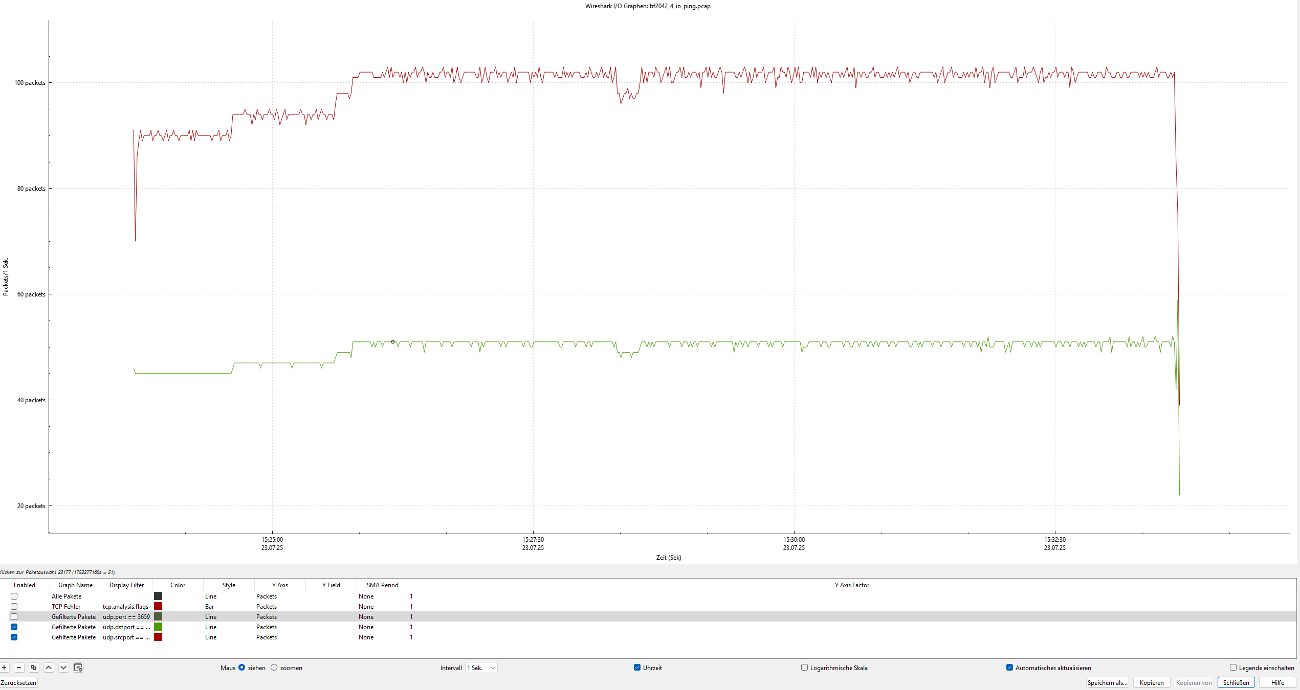

Screenshot (29).png (256.61 KiB) Viewed 1452 times
I can't interpret the values?

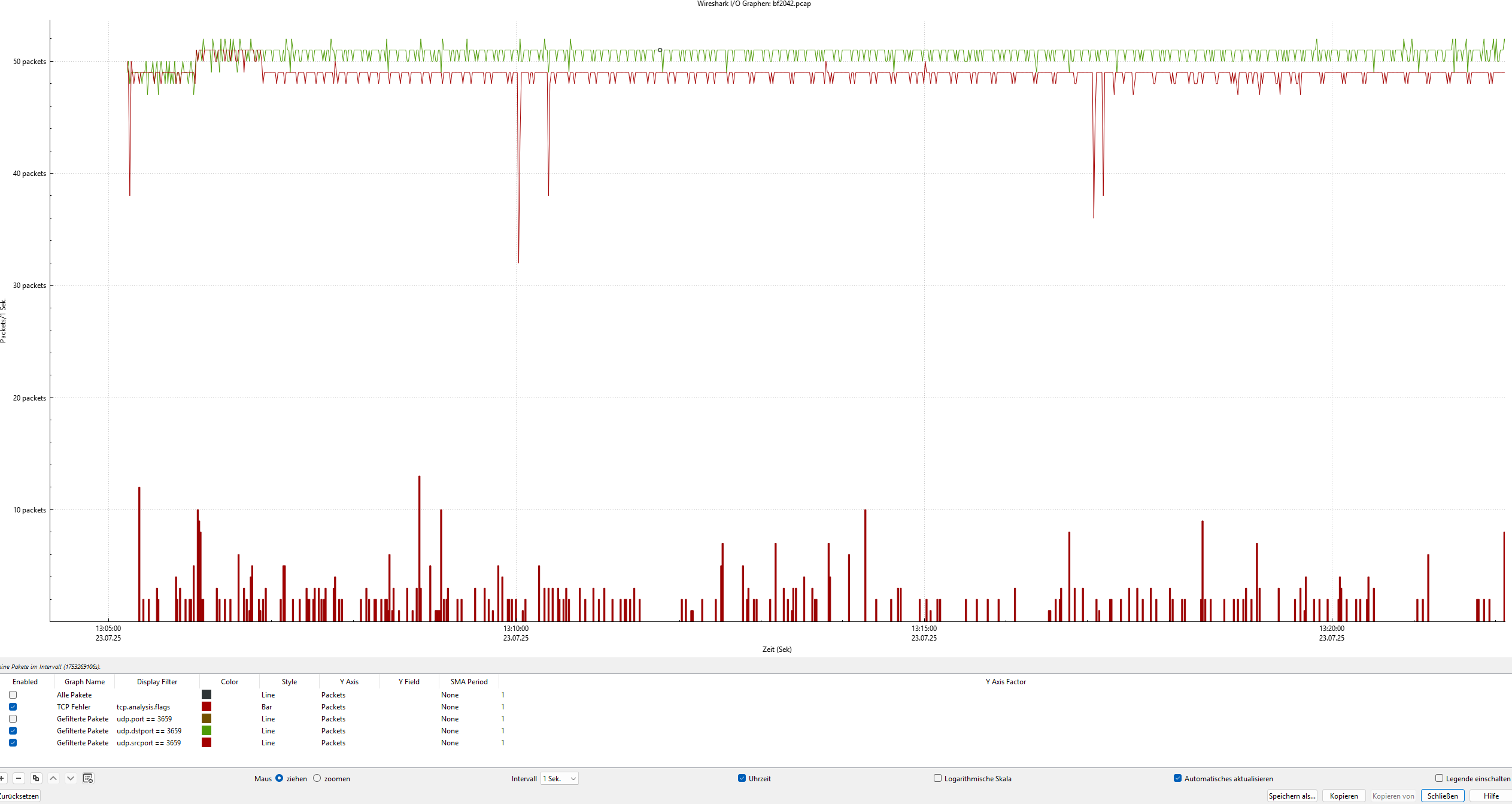

Screenshot (36).png (123.37 KiB) Viewed 1448 times

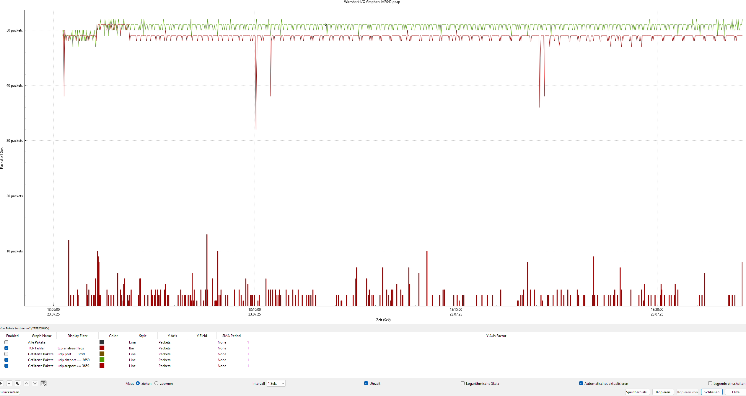

BF2042-Gameplay (Normal)
Screenshot (36).png (123.37 KiB) Viewed 1428 times
BF2042-Gameplay (+70ms Outbound-Ping)
Screenshot (38).png (106.21 KiB) Viewed 1428 times
Can someone rate this for me?

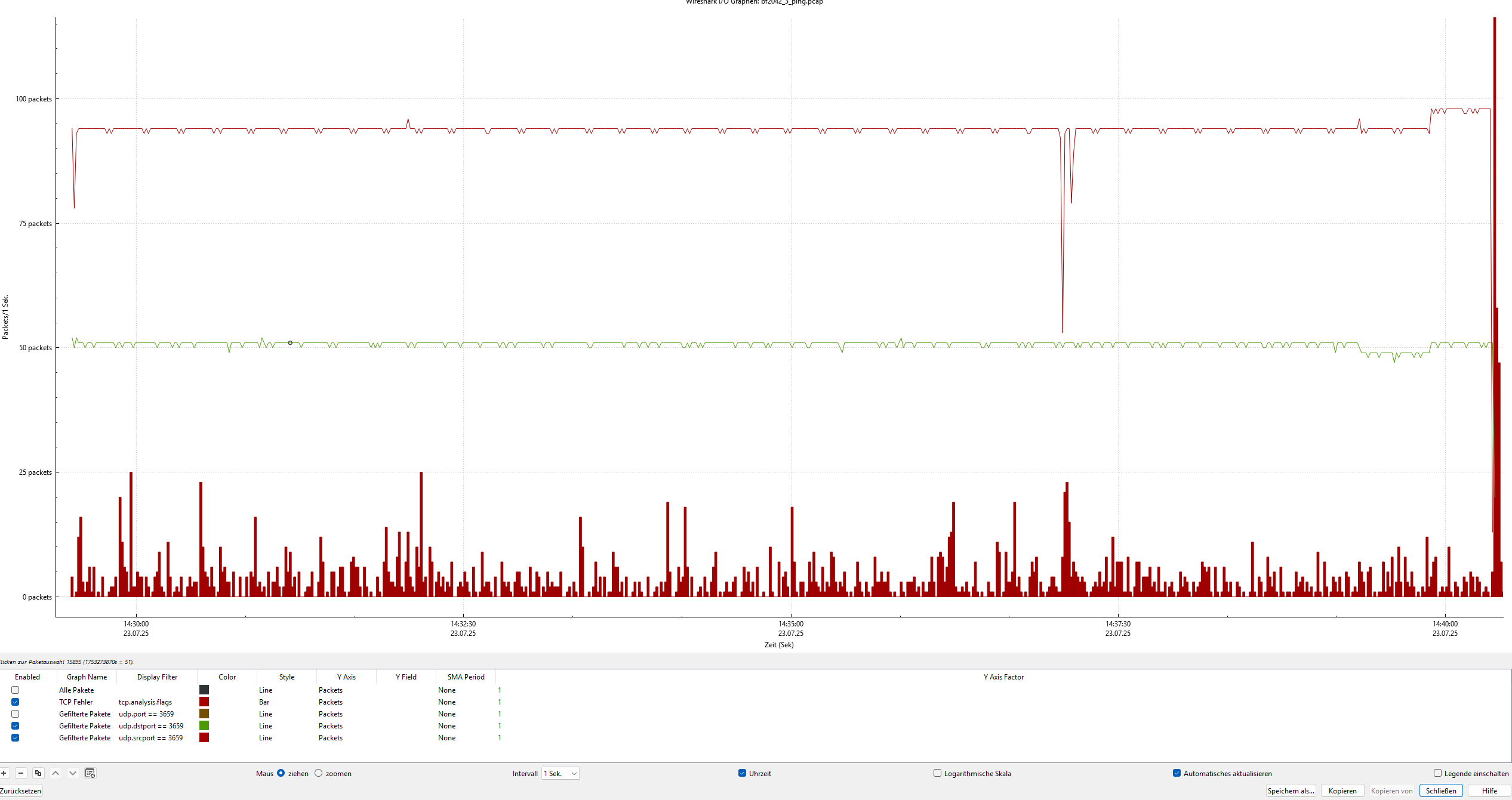

by LaggyTyp
+35ms inbound and +35ms outbound
Screenshot 2025-07-23 153550.png (121.63 KiB) Viewed 1412 times
My buffers (NIC) are both set to 1024. Maybe I need to increase this if I want to play with high ping (50-80ms)?
only outbound = good
inbound + outbound = bad (delayed)
PS: sorry for doublepost
