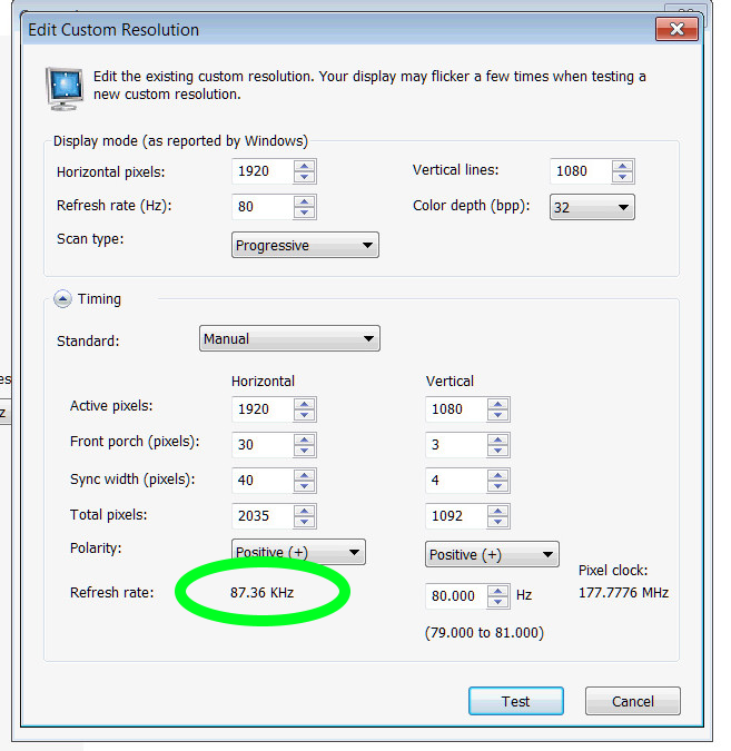

I want to try this with L4D2. My VT is 1092 as per download/file.php?id=987
So, to recap, my VBI space is 12, that means I can get the said equilibrium by positioning middle one at 540+24 and lowest one 1080-12?

Digika wrote: ↑
02 Nov 2020, 16:38
Give the tight VBI a try first, and see if you can get by.
VBI space is extremely tight for hiding a VSYNC OFF tearline unless you're doing force flushing.
The jitter amplitude of the VSYNC OFF tearline during RTSS Scanline Sync is usually more than 12 pixels, which means it's impossible to hide such a jittery tearline in the VBI. I'd lower the refresh rate to 72Hz to enlarge the VBI (keep reduced HT) to allow easier hiding of the VSYNC OFF tearline between refresh cycles. You might find it is a pro/con, 72Hz without tearing or 80Hz with tearing.
However, at only 87.36KHz horizontal scanrate, the tearline jitter may be fairly low, especially in games that use less than 50% GPU. Tearline will jitter more at higher scanrates (pixel rows per second), which mainly happens at higher refresh rates and/or higher resolutions.

I wonder if it just simpler to use FastSync since I have no issues with keeping up frame pace steady and FPS high.
02 Nov 2020, 17:30
I cant have any leeway with refresh rate since this is already overclocked P2414H that is specced to 60Hz. However, since I have GTX1070, L4D2 runs at about 400fps so there is no GPU demand.

Digika wrote: ↑
02 Nov 2020, 19:54
Distinction between horizontal refresh rate and vertical refresh rate: I am not talking about vertical refresh rate; I'm talking about horizontal refresh rate. Your screenshot shows an 87360Hz horizontal refresh rate (87360 pixel rows per second transmitted over the video cable, top-to-bottom scanout serialization sequence).
Mathematically, overclocking is just bandwidth bitbucket mathematics, assuming the firmware is VBI-size-insensitve. So, VT1092 80Hz (1092x80 = 87360, the scanrate) means at 72Hz, you can do 87360/72 = VT1213 at 72Hz. Or 87360/78 = VT1120 at 78Hz. As long as you don't increase Pixel Clock, you can sacrifice a smidge of vertical refresh rate into a larger VBI in this manner, keeping your overclocking within margins.
In other words, reducing by 2Hz makes a huge difference in hiding tearlines better (VBI of 40 lines versus VBI of 12 lines), a 3x bigger tearline-hiding window.
However, try calibrating 80 Hz first and see if you can hide tearlines fully in L4D2 without needing to increase VBI. Use the new RTSS moving-bar feature to help you calibrate.
To highlight your screenshot, about the horizontal refresh rate (known as scan rate, in terms of number of pixel rows per second; your mode transmits one pixel row from GPU to monitor in 1/87360sec).

by Digika
02 Nov 2020, 20:24
Oh, my bad, read it wrong.
Yeah, that makes sense. Problem is I dont know which front porch and sync width specify for that. I believe this current custom 80HZ setup for my Dell came from this forum a few years back, but I'm not particularly deeply familiar with aspects of overclocking RR.
Yep, fair point.
