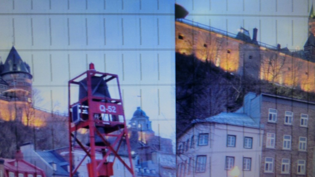

LogicElite wrote:Chief, in fact, even with these parameters on the quebec image, I can see the a light red offset from red structure when motion blur is enabled. I tried to take a picture with my digital camera without success.
You need to pursuit the camera. Turn on the Pursuit Camera Grid, then take a picture while moving the camera sideways. A tracking camera more accurately simulates tracking eyes. It works best when you follow the pursuit camera instructions, but hand-pursuiting the camera has sometimes worked.
1. Turn on pursuit camera grid, example www.testufo.com/photo#pursuit=1
2. Set camera exposure to three or four refresh cycles long (1/30sec for 120Hz)
If you can't get an exact exposure, you can get close to this by playing around with exposure compensation & screen brightness
3. Pan the camera sideways while taking a picture (this simulates tracking eyes more accurately)
4. If the grid look bad, repeat step 3 until the grid looks reasonably good (less than 1 pixel offsets in alignment)
5. Post photo.
More complicated instructions are found in the pursuit camera instructions, for a better understanding of how this works.
Example hand-panned pursuit camera photo of www.testufo.com/photo
This is a photo of LightBoost/ULMB, camera panned by hand (rather than camera rail). Strobe crosstalk is very minor in this photo (see vertical edges).
Ok is not perfect (taken from a Canon PowerShot SX210 IS) but you can notice the offset on the red structure.
