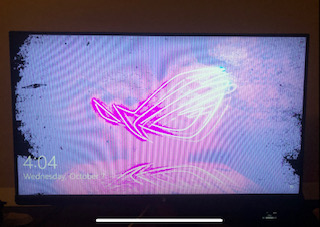

I’ve had my monitor for about a week now. Twice this week (every 3-4 days) when I powered on my computer the image for windows/boot/bios could not display colors properly. The OSD menu was unaffected.
The first time this happened, I replaced the DP cable and the image appeared normally, I thought maybe I had a bad cable. The second time, I disconnected the DP cable and connected another device via HDMI, same issue. I reseated the power cable from the back of the monitor, and the image appeared normally.
I checked the DP cable I thought was bad from the the first time this happened on another monitor, it worked normally.
I saw a user on another forum with the same issue.

Re: Official Asus ROG Swift 360Hz PG259QN Owners Thread
It's supposeed builded with high quality electronic components, and pass good quality control. Lest hope this is not the reason, or game over.
Check than DP cable not touch any power cable.
Make sure PC Case is free of static electricity. All PCIe cards touch metal case where it is screwed. And DP connector metal is directly touching here.
Try another DP port.
Maybe the GPU is unstable at 360Hz, if 360 fail and changed to 240Hz is solved ? again 360 again fail ?
Several recent custom RTX 3080 can't maintain its factory overclock at max load due to caps issue. Due to this cut quality plague, maybe this OC unstability also extend to DP port if you have one of these cards.

No idea if this would help, but did you install this, https://www.asus.com/us/Monitors/ROG-Sw ... _Download/d3f wrote: ↑08 Oct 2020, 12:52I’ve had my monitor for about a week now. Twice this week (every 3-4 days) when I powered on my computer the image for windows/boot/bios could not display colors properly. The OSD menu was unaffected.
Do you have VRR enabled for Windows or any other gaming prioritization enabled in Windows (aside from Game mode)?
Edit: I'd contact the ASUS regardless. When you switched Display ports was the device left powered on? If the OSD was unaffected especially where the black is it seems like something else. As mentioned are you running a 3000 series card? Are you set to 8 bit 1080p @ 360hz Full RGB?
- Download latest GPU drivers and DDU
- Safe mode no networking and DDU GPU drivers
- Booting back normally make sure your NIC is UNPLUGGED and there is no wireless connectivity
- Install Drivers only. No USB C, no Geforce Experience, just drivers
Are you plugged into a battery back up, powerstrip, or directly into the wall?

Hi All, thank you for the responses!
AddictFPS - DP cable is not touching any power cable or any other cable.
Alpha - I do have the ASUS monitor drivers installed, I installed it a day or two after I received my monitor. I do not have VRR or other prioritizations enabled. Also, this issue does occur when I enter my motherboard BIOS as well as during boot. When I switched display ports, the monitor was powered off. I would be running a 3000 series card if I could get my hands on a Strix lol, currently I'm using a 2080ti. Monitor is plugged in to a power strip, different from the one it was connected to when this issue happened twice before. I've also download the latest drivers and DDU.
I've called ASUS support, they recommended I either send the monitor back to them or return to my retailer. I'm going to initiate an RMA, considering this has happened twice already and I know of another user that is experiencing the same issue I don't want to take a chance it might get worse.
The monitor is absolutely amazing otherwise, I have no issues with it's performance.

That is a trip. OSD is fine really makes it seem like the display isn't the issue but better safe than sorry!!! What type of turn around did they tell you to expect?d3f wrote: ↑09 Oct 2020, 10:28Hi All, thank you for the responses!

Yeah it definitely is a trip, I've never experienced anything so sporadic before with a monitor.
I called Newegg and they told me to return for a replacement, since there is no stock, it will probably convert to a refund. My only concern is that if/when the monitor is inspected it will function normally as this issue only occurs every few days. The customer service rep did note in the RMA that the issue sporadic, occurring every few days. We'll see what happens...
I was able to purchase a 3090, it should be here on Tuesday, I'll install it and see the if the issue happens again.
