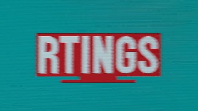

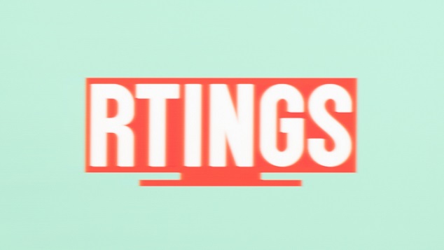

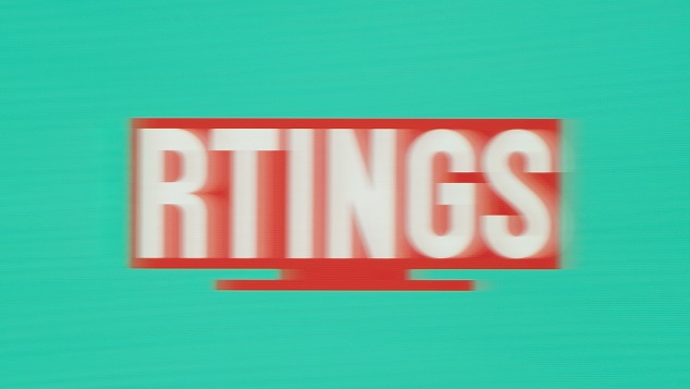

I 2nd pretty much everything AddictFPS said.
The biggest issue with the LG OLEDs and other OLED TV's that use the LG panel seems to be the 4ms MPRT at 60nits limit. I dare say 60hz-single-strobbing on the LG OLED's is simply too dim for most. And strobe-width isn't fully adjustable with brightness like it is on the Vizio.
Below seem to be the three most interesting TV's when considering backlight strobing. Flagships of LG, Samsung, and Vizio respectively. TCL and Sony seem to underperform so I've omitted them. Bare in mind RTINGS BFI testing is extremely limited and they only specify that these pursuits were taken at backlight 100%.
LG CX https://www.rtings.com/tv/reviews/lg/cx-oled
Samsung Q90T https://www.rtings.com/tv/reviews/samsung/q90-q90t-qled
Vizio P-Quantum X 2019 https://www.rtings.com/tv/reviews/vizio ... tum-x-2019
It would seem that Vizio > Samsung > LG > Other
Its difficult to see the difference in brightness over photos, but its clear the Vizio has tons of headroom for lower MPRT. I think the fundamental problem with OLED is simply brightness. Very low CRT-like MPRT at good brightness can only be achieved by a massively bright strobe. LCD backlights are still 3x brighter than OLED at the high-end (3000 nits vs 1000 nits).
That being said, the LG should probably do much better mathematically speaking with 1000 nits. The strobe on the LG is likely nowhere near 1000 nits for MPRT and brightness this bad. I'm not sure if LG is already doing a rolling-scan strobe to combat fullscreen-brightness-limitation on OLED. If they are not, that might be an area of further improvement.
A perfectly implemented 1000 nit strobe at 60hz should produce 1.7ms MPRT 100nits.
The 1000 nit Vizio P65-F1 is within the margin-of-error of this target. LG CX is nowhere close, despite being capable of 1000 nit highlights in HDR.
