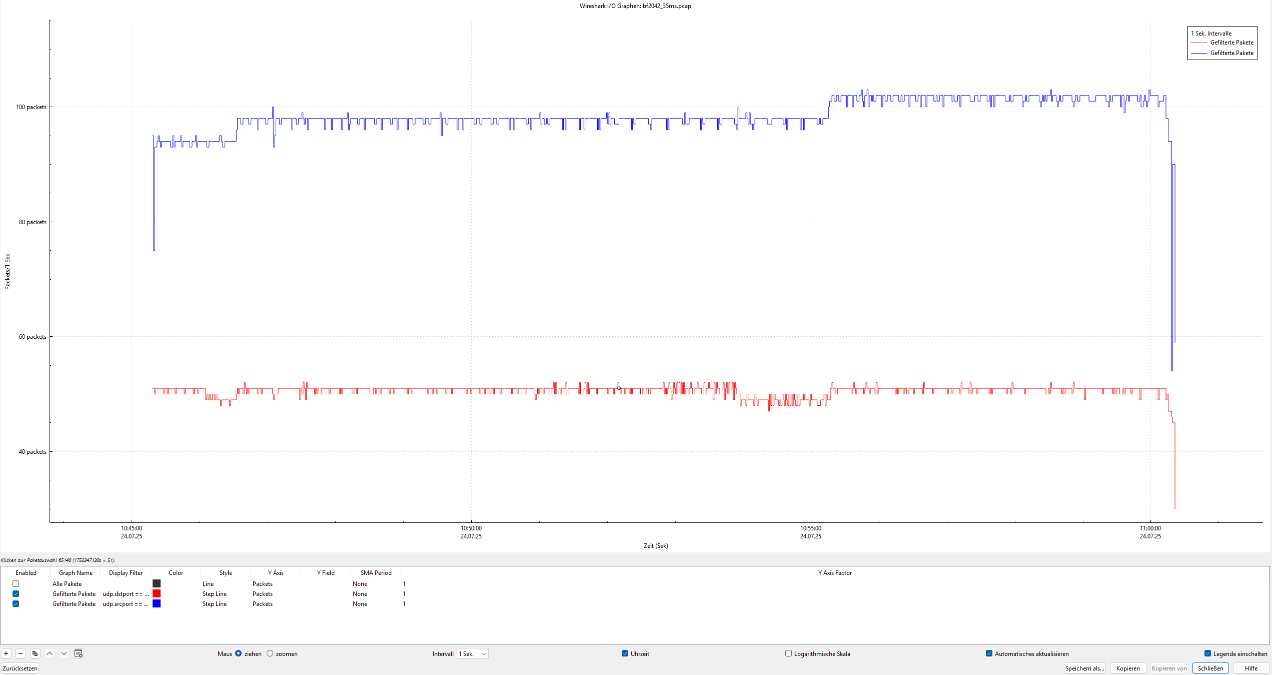

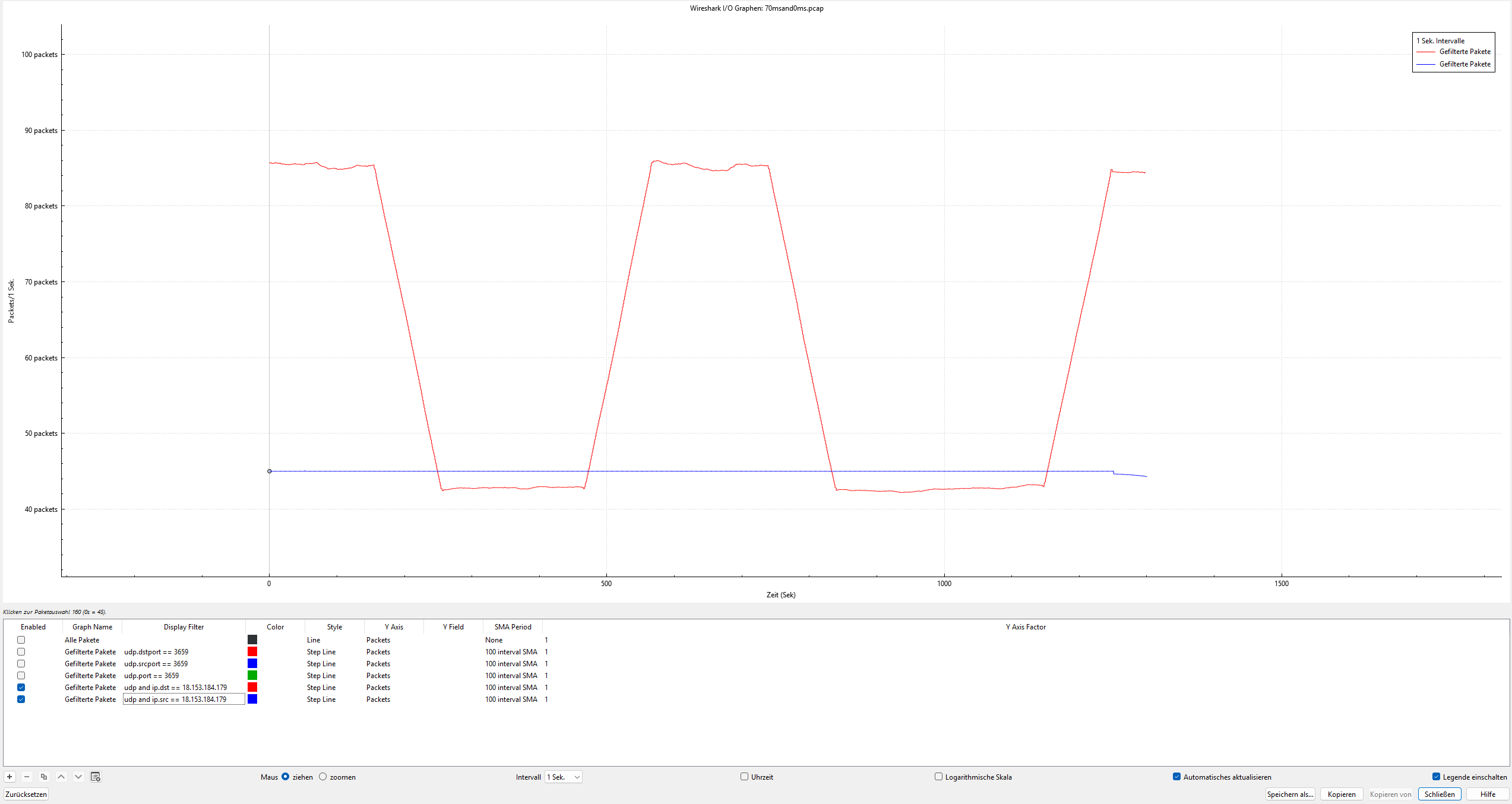

I'm surprised that I'm sending ~100 packets per second (client to game server) when it should be 45 packets per second.
Screenshot 2025-07-24 110123.png (81.41 KiB) Viewed 1804 times
Screenshot 2025-07-24 110753.png (121.44 KiB) Viewed 1802 times
LaggyTyp
Posts: 219
Joined: 07 Apr 2024, 16:16
Re: No FPS gaming possible
Post by LaggyTyp » 25 Jul 2025, 05:47
@ChristophSmaul1337
Could you please record a round of BF2042 for me and show the transmit and receive directions? My game sends over 100 packets. How about yours?
LaggyTyp
Posts: 219

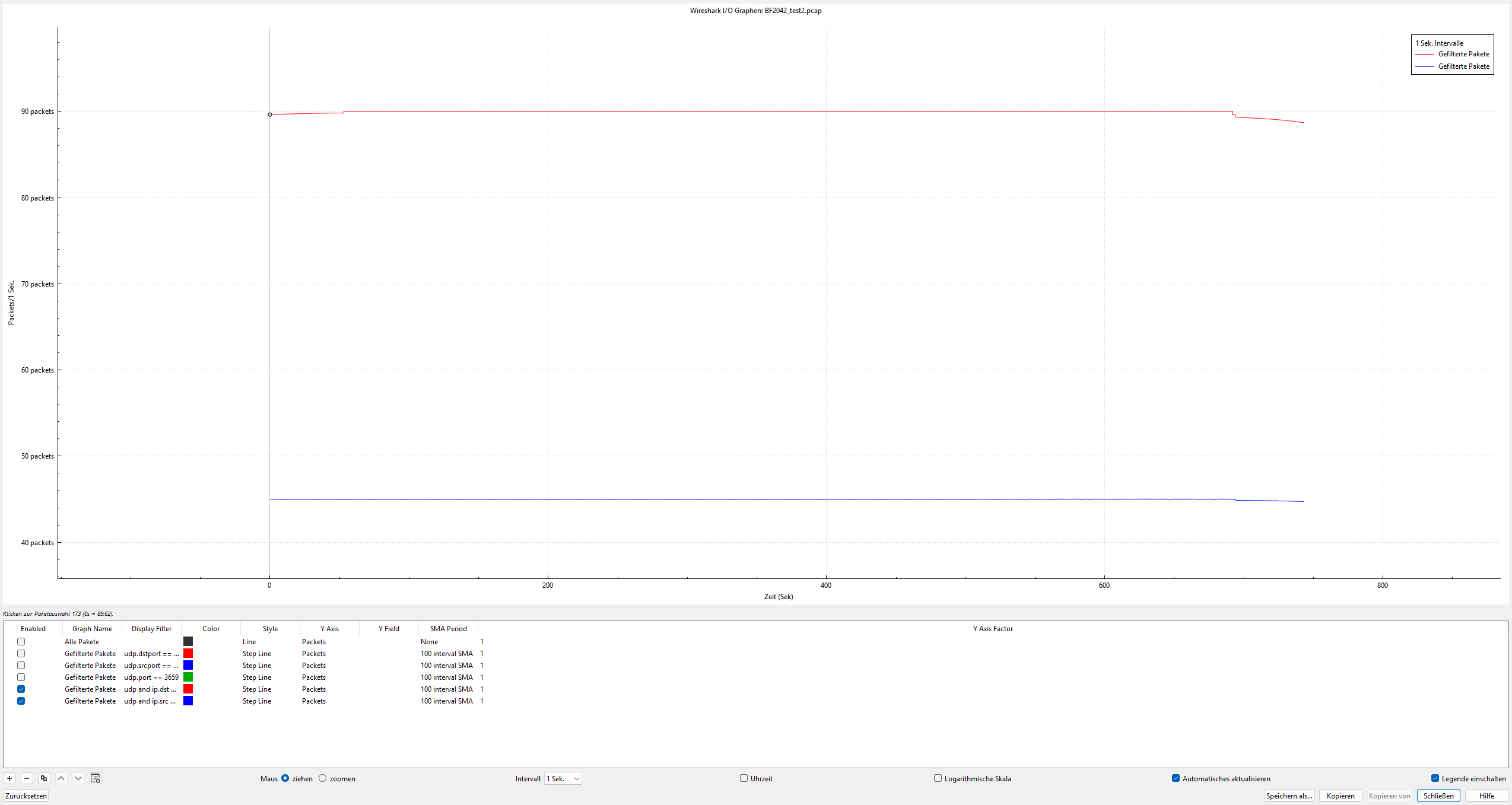

Post by LaggyTyp » 25 Jul 2025, 09:09
I started the round with an outbound ping increase and then turned it off again in the middle.
Screenshot 2025-07-25 160731.png (89.94 KiB) Viewed 1675 times

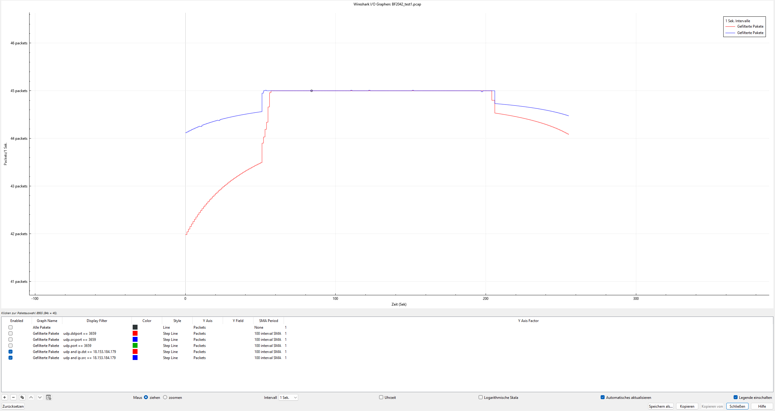

ChristophSmaul1337
Posts: 114
Joined: 11 Feb 2024, 21:01
Post by ChristophSmaul1337 » 25 Jul 2025, 12:57
LaggyTyp wrote: ↑
25 Jul 2025, 05:47
Round of Haven Conquest 64 on a Frankfurt server with 6ms ping. Not quite a whole round, as it was basically over when I joined. You can't see both graphs because they're exactly overlapping each other. Nailed at 45 packets/s both in and out.
What you're seeing might or might not be normal, but I assume the game just can't handle a massive ping difference between up- and download direction. The game can't even handle normal pings, lol.
As I said before, I can't help you here anymore, as to me your connection looks fine. The packet loss test together with the game's diagnostic overlay not showing any icons is enough evidence for me to come to the conclusion that your internet isn't to blame.
Also, there's always one more view angle you have to approach these problems from. You've perfectly stated it yourself here:
LaggyTyp wrote: ↑
23 Jul 2025, 15:27
But the truth is: If it's good, then it's good without these changes.
Beautifully said. Think about the millions upon millions of gamers out there, playing online FPS games right now as I type and you read this posting, without any kind of problem whatsoever. Now think about how many of those are on a DOCSIS connection. Now think about how many players have an "unoptimized" computer, 3 anti-virus software solutions stacked on top of each other, bloatware as far as the eye can see, loose cooler screws causing thermal throttling 24/7, incorrectly configured RAM in single channel, playing over WiFi with the routher behind 4 concrete walls, and so on. You can think of any possible way to build your computer wrong, at least some tens of thousands of people are playing like that right now without any problem. Same with internet connections: You can even play on a connection with 10% packet loss and you'll not notice the kind of problems you're getting where your view is heavily desynced from the server. This isn't even happening with 100+ ms of ping, and watching CS pros from Russla playing FACEIT with 80+ ping while still being able to outfrag everyone as if they were bots, proves this point.
Bottom line for me is that your internet must be seriously, and I mean horrendously, f'ed up in order to maybe show these kind of problems. We're talking 80%+ packet loss and 500ms+ ping. And even then, I've played Battlefield 3 on a 250 ms ping Japan server back in the days and I've not gotten these kinds of desync problems there. If that was what's happening to you, you definitely would know.
For your question about sending more packets than usual, try this: Change the filter in the Wireshark I/O graph. Delete the udp.srcport filter and instead do this:
"udp and ip.src == XXX.XXX.XXX.XXX"
where X is the server's ip. You can find the server IP from the packet capture. For the other direction, do
"udp and ip.dst == XXX.XXX.XXX.XXX".
Maybe your game client is sending some other information on the same port, you never know what they're doing. Honestly, it wouldn't surprise me if DICE spaghetti code would strike again here.

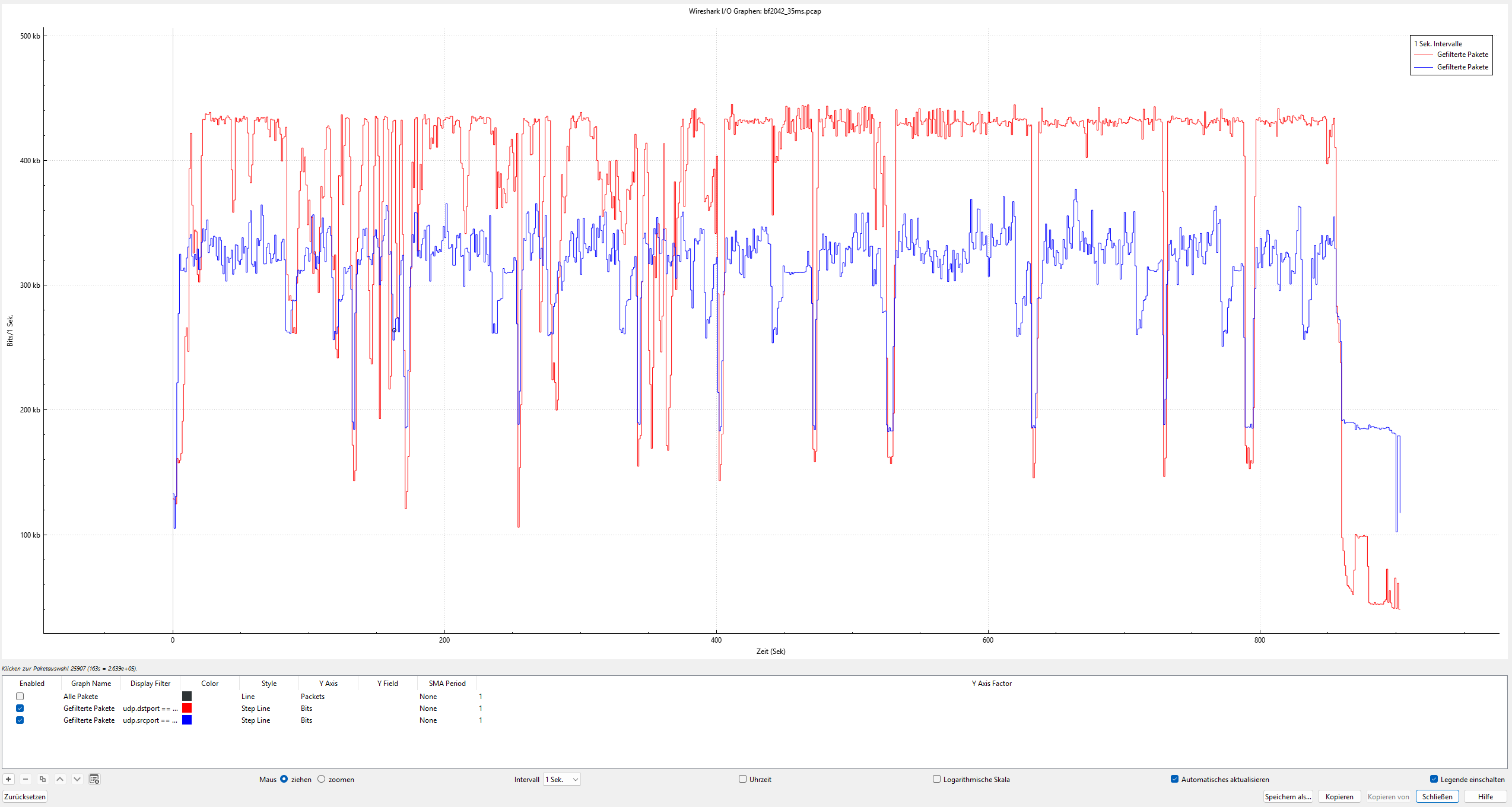

Post by LaggyTyp » 25 Jul 2025, 15:22
Could you please show your settings on the screenshot (like I did)? That is, everything below the graphic, so I can set it the same way you did, which would be easier to compare.
Screenshot 2025-07-25 222046.png (88.46 KiB) Viewed 1578 times
I'll do a few more tests and get back to you.
PS: I turned the ping tool on and off several times. Hence the strange curve.

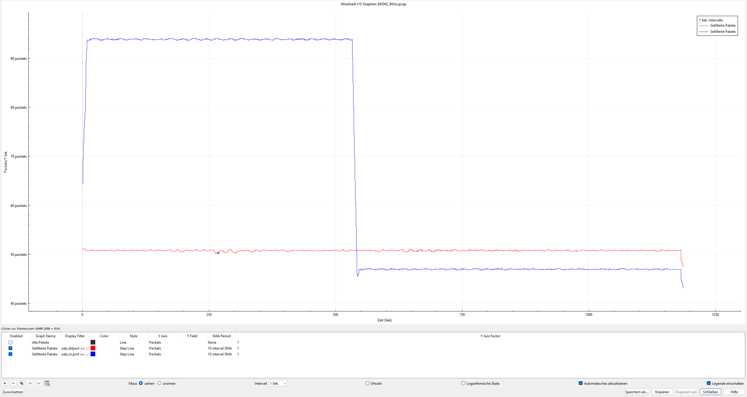

Post by LaggyTyp » 25 Jul 2025, 15:58
BF2042 normal:
Screenshot 2025-07-25 224545.png (76.44 KiB) Viewed 1554 times
BF2042 with +35ms inbound and +35ms outbound
Screenshot 2025-07-25 224636.png (69.46 KiB) Viewed 1554 times

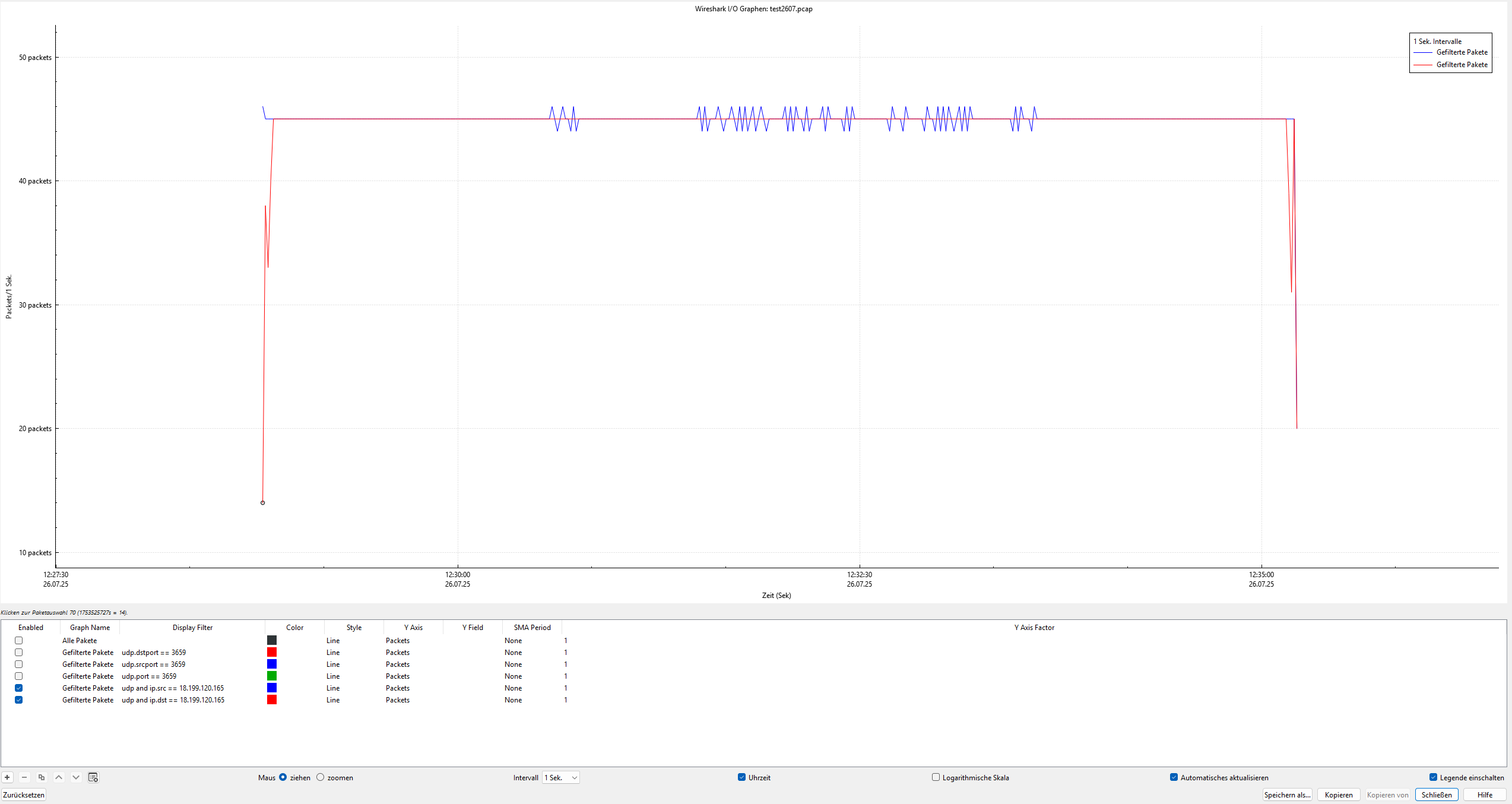

Don't you think the incoming packages (blue) look strange with the spikes?
Screenshot 2025-07-26 124039.png (82.72 KiB) Viewed 1397 times
