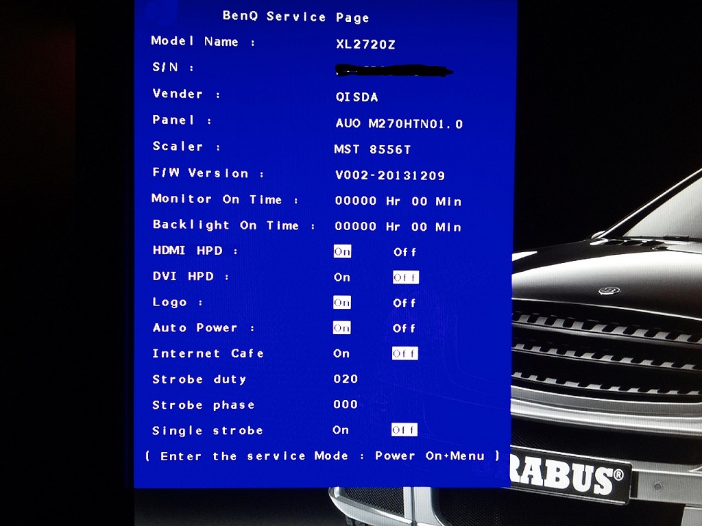

Good day! After the firmware version on XL2720Z v.2 in service three new menu item:
Strobe duty - 020
Strobe phase - 000
Single strobe - off
What they are responsible and how to use them properly?
Falkentyne
Posts: 2805
Joined: 26 Mar 2014, 07:23
Re: ANNOUNCED: Blur Busters Strobe Utility -- for BENQ Z-Ser
Post by Falkentyne » 03 Apr 2014, 05:09
same as in the blurbusters utility. Persistance, crosstalk, and single strobe turns on <75 hz strobe (60 hz flicker) instead of double strobe when its 75hz or under.
