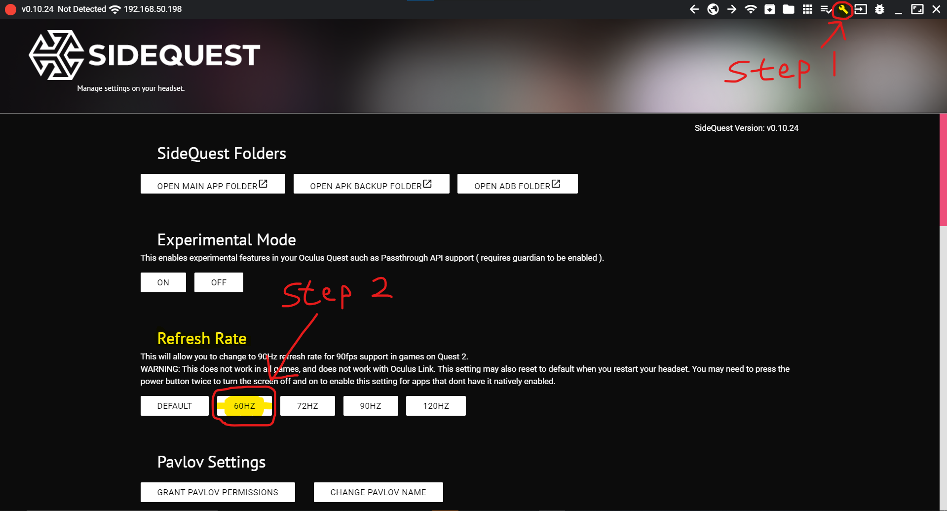

I have looked into system wide 60hz-single-strobing and you are very much correct!
One must make their Facebook/oculus account a developer enabled account and then options to enable developer mode will appear on the headset and the oculus app.
SideQuest software on PC will now be able to detect when the oculus quest 2 is connected via a link cable. Once connected, you can click on the wrench in the top right corner and force a system wide refresh rate change which stays in effect until the quest is rebooted.
Screenshot 2021-08-17 154831.png (354.81 KiB) Viewed 27343 times
I believe this can also be done on Android wirelessly with SideQuest app for switching refresh rate more conveniently without PC.
This allows you to play 60hz games/emulators as well as those that can be side-loaded with 60hz-single-stobing all with no PC. This seems most useful for watching twitch and YouTube 60fps gaming content in zero-motion-blur fashion. Totally portable 60hz CRT-style motion blur without the need for a computer because it is system-wide for the quest 2.
Unfortunately, there seems to be stutter problems here too. Watching 60fps videos in oculus browser produces the least problems. YouTube VR and Firefox stutter badly (interestingly, YouTube VR has a 60hz mode to save battery in the app without the need for sidequest, but stutter is bad).
Setting the system-wide refresh rate to 60hz does not help stutter in virtual desktop unfortunately.
