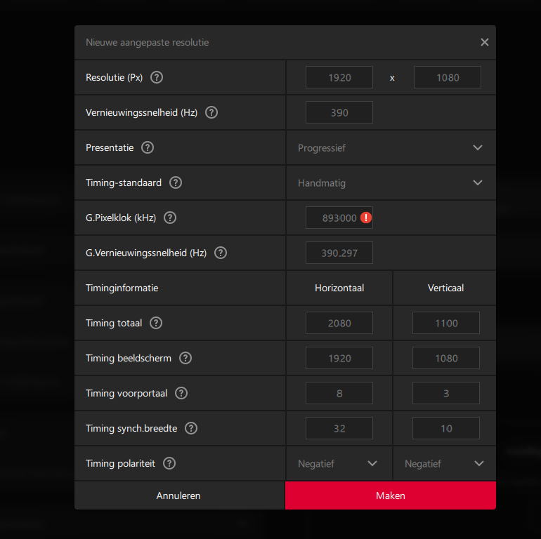

Hey guys,
I'm having some trouble, what am i supposed to do in this situation?
Iwant to create a new resolution for csgo which is 1280x960 but can't seem to find a way to fix this g.pixelclock, can you guys help me out? thx!

krypton61 wrote: ↑
09 Mar 2022, 15:47
Hey guys,
According to tlp you might get lucky by using CRU and:
...deleting all the extension blocks/resolutions and then copying the 390hz timings that the nvidia control panel displays into a DisplayID 1.3 extension block.
Example: Image
