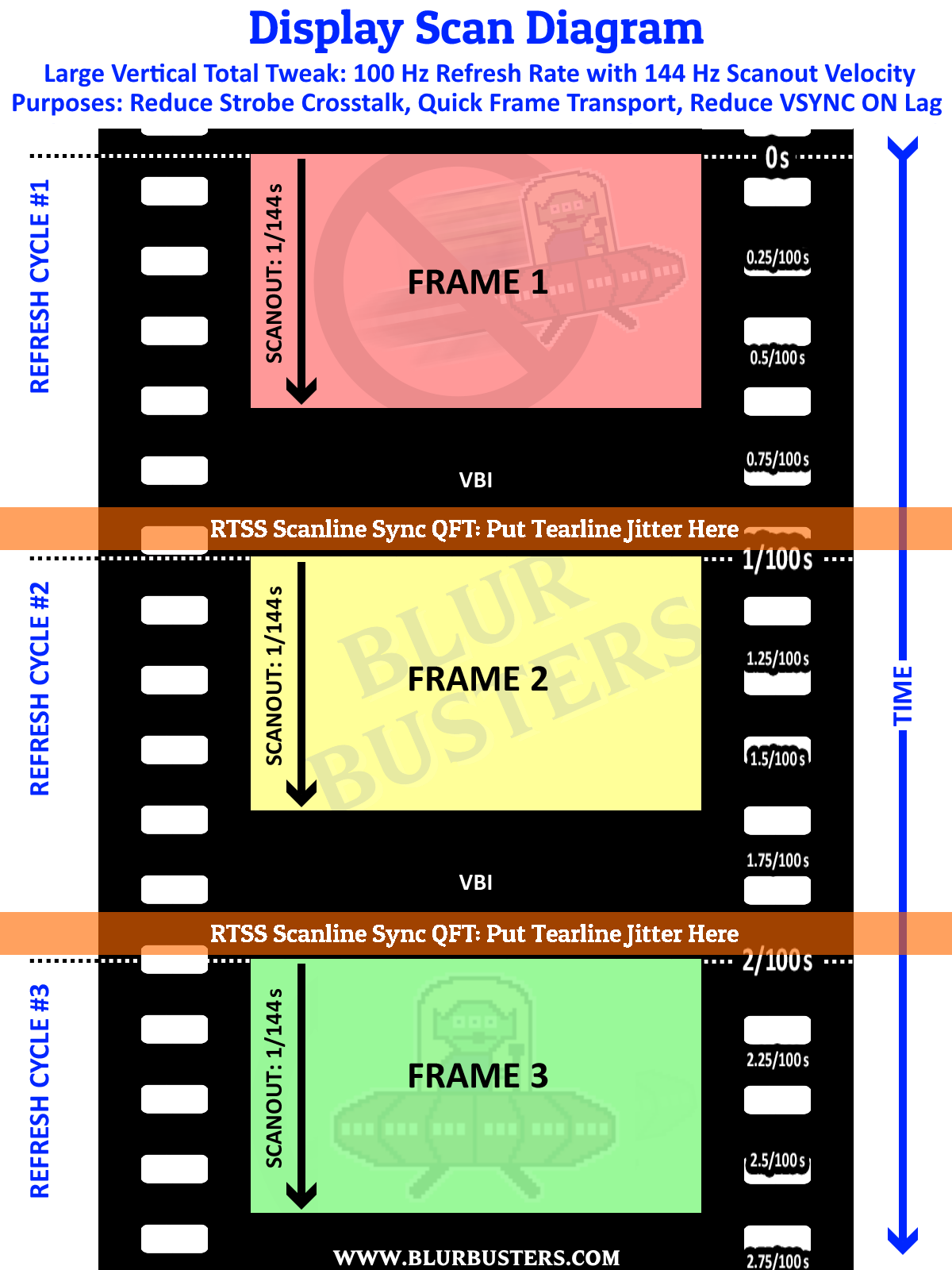

I've never said that QFT eliminates tearing unless you're using RTSS Scanline Sync
Are you using RTSS Scanline Sync for the tearingless VSYNC OFF techniques?
QFT does make it easier to hide tearing with RTSS Scanline Sync, because of a bigger VBI for VSYNC OFF tearlines to jitter inside unseen offscreen, at framerate=Hz. If so, please post your Scanline Sync settings and I can help you.
If not, remember your GPU load needs to be roughly ~50% or less at 190fps for tearingless VSYNC OFF to work reliably. If your goal is eliminating tearing at the lowest lag possible, you may have to adjust your refresh rate down (while increasing the QFT factor to maintain the low latency of lower refresh rates) -- until GPU load falls enough to allow reliable scanline sync.
In this use case, the bigger the Vertical Total, the more room in the VBI to hide tearline jitter using scanline-based frame rate capping techniques. RTSS Scanline Sync steers to raster-precise VSYNC OFF in the blanking interval between refresh cycles, moving the tearlines off the top edge of the screen.
The bigger the Vertical Total (bigger VBI), the more room for erratic timings to still keep jittering tearlines hidden in the VBI. But it must be done simultaneously with extra software such as RTSS Scanline Sync or Special-K Latent Sync, both of which are raster-methods of steering VSYNC OFF tearlines to a precise position (such as offscreen).
