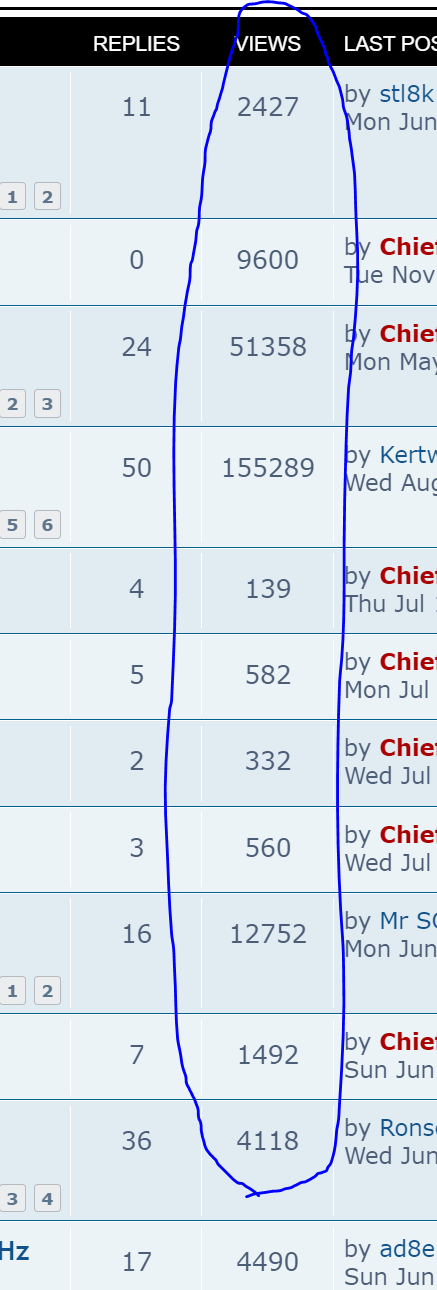

Most readers in this forum won't read this in this specific forum area. Chief Blur Buster may move these types of threads to one of the Laboratory forums. Walls of texts about technical monitor/testing are highly encouraged in the Laboratory forums, such as Area 51 or Pursuit Camera, etc
Honestly, I want to encourage more forum posts like these on Blur Busters, because I like to discuss technology matters.
Personally, I encourage Walls of Text in Area51 or other Laboratory forums, and we badly need to recruit more researchers & Walls of Text over there, because some of us (myself, Futuretech, CRTgimp, STL8K, thatoneguy, etc) actually read these walls of text. Those are the forum members that [almost] never posts anywhere except in one of those "Laboratory" forums.
Since over 50% of Blur Busters corporate income is via collaborations with manufacturers/vendors/clients/etc involving very Aera51 topics; the revenues help keep these forums running... To me the General forums is to keep fans happy, while the Blur Busters Special Sauce is Laboratory stuff ( www.blurbusters.com/area51 ). Big Walls Of Text included.
If you look closely at Area 51 Post-Read Counts you notice many read walls of texts at Blur Busters, but they are mainly a totally different audience in Laboratory. I check my web logs too, and many are coming from real users instead of bots, and curiously a high read count from various corporate headquarters (despite low public reply counts).
This is considered, to me, a medium size wall of text, not nearly as big as the wall of texts found in Laboratory.
The totem pole generally is walls of texts gets posted in a forum further down the screen at https://forums.blurbusters.com such as one of the Laboratory forums.
