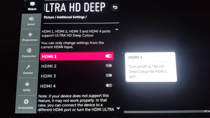

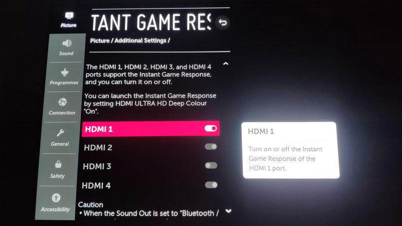

- HDMI Ultra HD Deep Colour ON
- HDMI Gaming Instant Response ON and OFF
- HDMI Source Type defined as PC and Console
I did not find a VRR setting on the LG C9, but according to this forum, that parameter does not exist on the TV side.

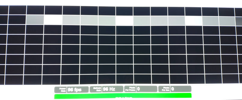

I re-checked my custom resolutions using this adapter at 1080p and 4K.
TestUFO frameskipping is OK at 120Hz and 100Hz but always indicates dropped frames at 96Hz.

- Posts: 12272
Re: LG C9 underclocking to 96Hz
Duplicated frames. Brighter squares = repeated refresh cycles.
It looks like 120Hz creating a 1:1:1:2 pulldown effect.
Damn, it's too bad that the older C9 doesn't work with this. The QFT trick is more compatible with VRR panels, so VRR-free panels are far less likely to work with QFT fixed-Hz 96Hz.
This works much more successfully on newer OLEDs with VRR turned on.

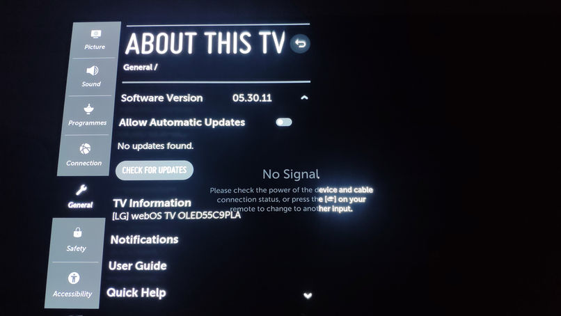

>> 1. Upgrade to latest C9 firmware. Early C9 firmware do not support VRR.
Already done : 05.30.11
>> 2. Please turn on "Instant Gaming Response" to get the hidden VRR menu option to appear.
Already done : "Instant Gaming Response" is ON.
"Ultra Deep Colour" is ON too, as some forums tell to switch this OFF then ON again to activate VRR. I tried but no VRR with that either.
>> 3. Then turn VRR on in the television menu.
I don't have a hidden VRR menu option.
Please where did you read about it ? All that I've found is people telling there is no such option on the tv, and that is automated when the source is vrr ready.

- LatestDriver.jpg (38.09 KiB) Viewed 13123 times
- Instant Game Response ON.jpg (45.13 KiB) Viewed 13123 times
- Ultra Deep Colour ON.jpg (48.63 KiB) Viewed 13123 times

Oh, right, I forgot -- "Instant Gaming Response" automatically turns VRR on. That's the setting.
