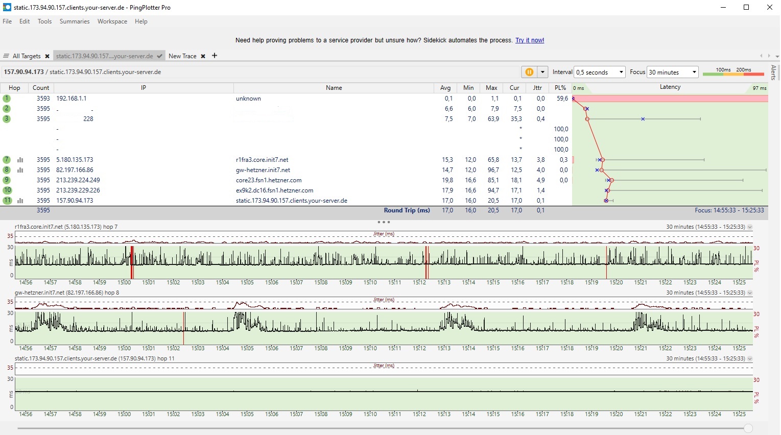

I run freshtomato on an overclocked r7000.
Just ran a idle trace to a CSGO server, this just can`t be good right? What the fuck is this even?

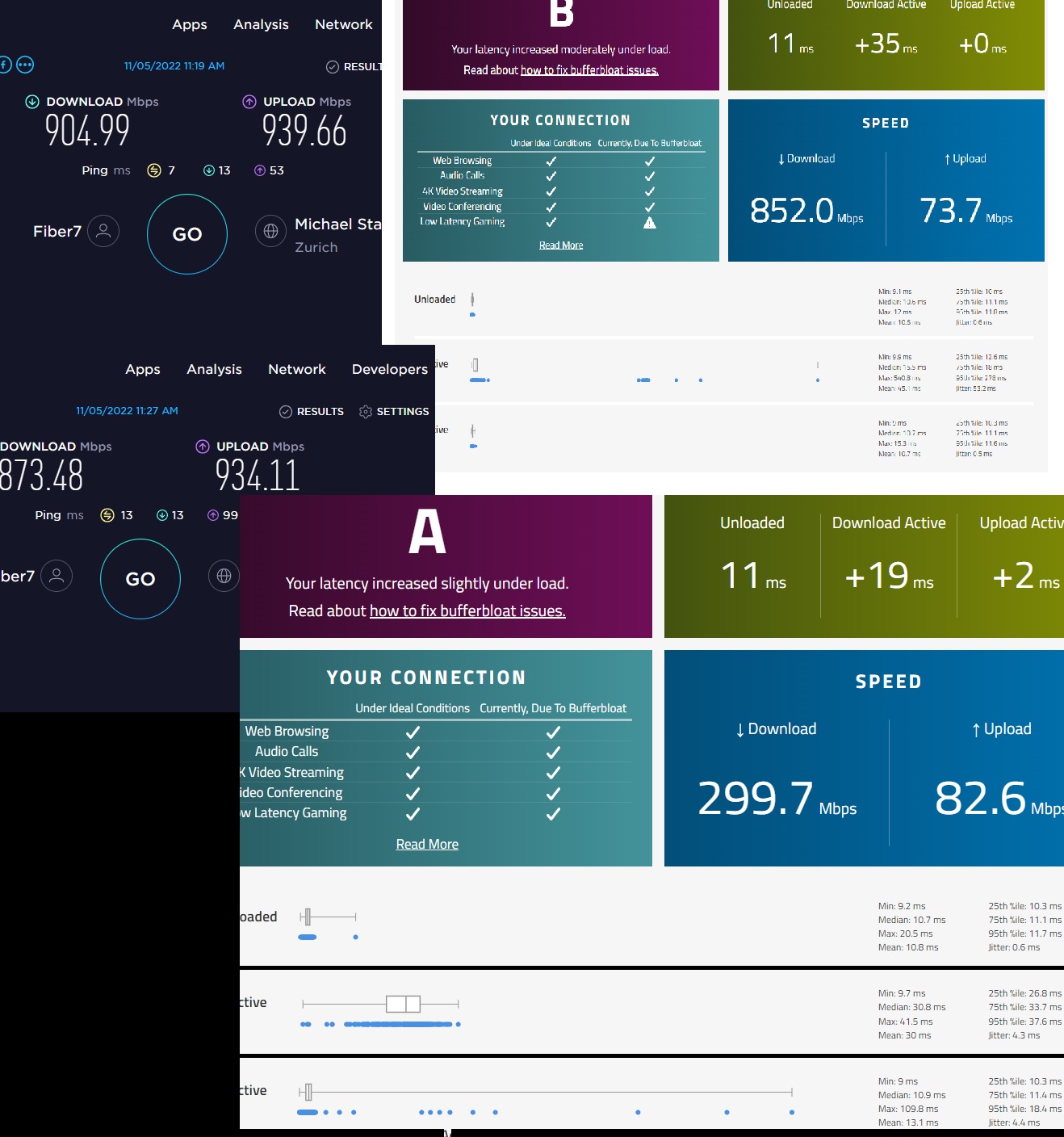

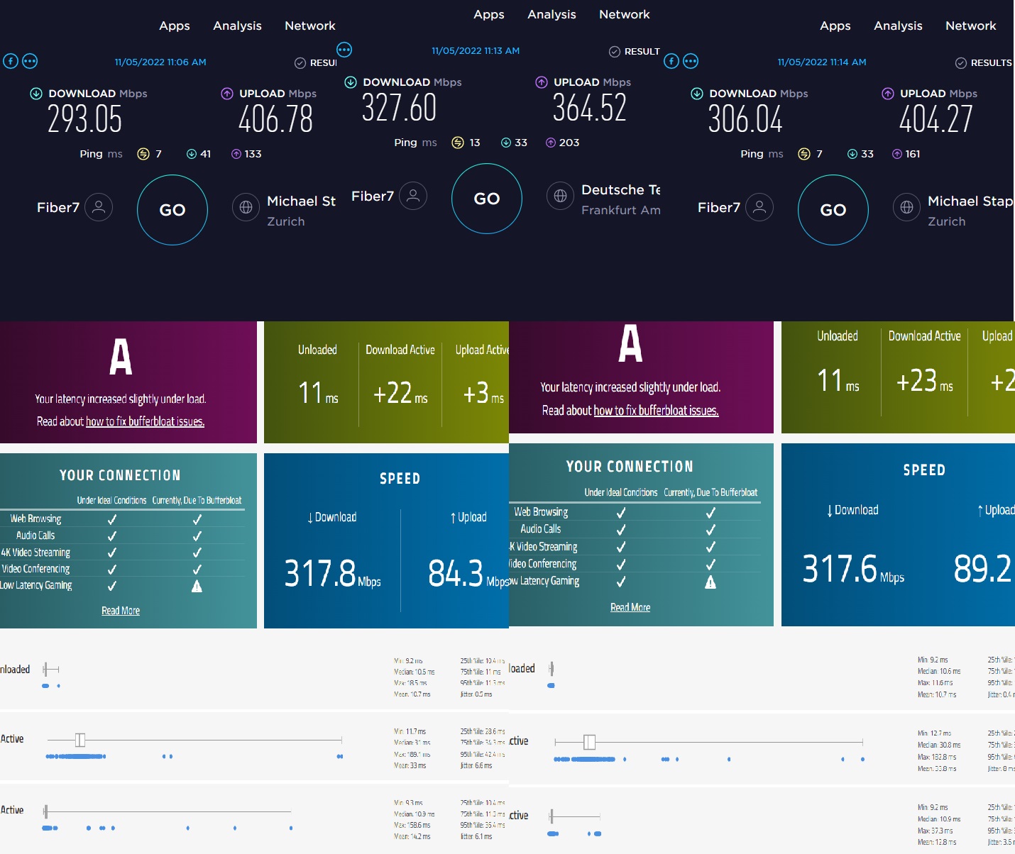

For comparison 1gbit connection on FTTH.
All traffic shaping is done on ISP side even though I could do it also on my side, I don't need to.
Second ISP also with FTTH and using same routers does have much worse bufferbloat, but even with shaping on my router it does not get as good as the first one.
When I had this issue, I also switched between both ISP, there was never much difference in gaming (only ping was different on different servers and routing a bit different)
When forcing low speeds on browser, you should also get good results.

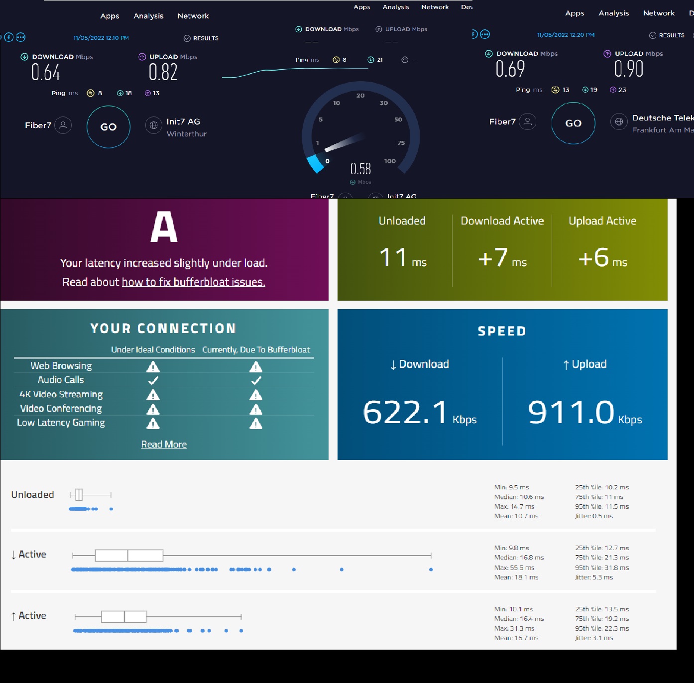

Re: Bufferbloat on FTTH
Posted: 05 Nov 2022, 12:06
by 1000WATT

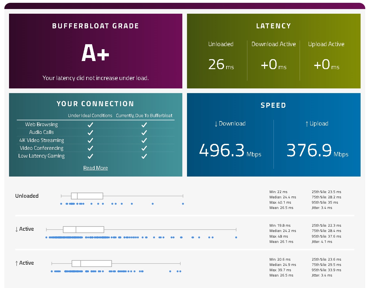

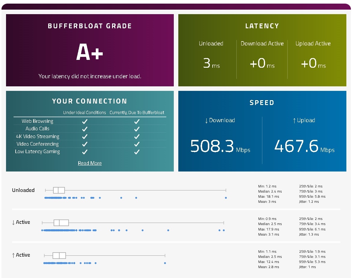

There are 5 providers in my house, 3 large companies, and 2 local small resellers. Large companies ignore all messages in support.
These are the results of 1 fiber from a major provider.
These are the results of 1 local reseller, after I came to the office and talked to a senior engineer, I offered a reward bypassing the company, and I was lucky, the engineer got his ass off his chair and did what I asked.
Posted: 05 Nov 2022, 12:11
by n1zoo

1000WATT wrote: ↑
05 Nov 2022, 12:06
I did the same and within 2 weeks they promised to upgrade their infrastructure because it's obsolete and it has not been touched for 15 years at least. I hope they will take it seriously and install something above my expectations.

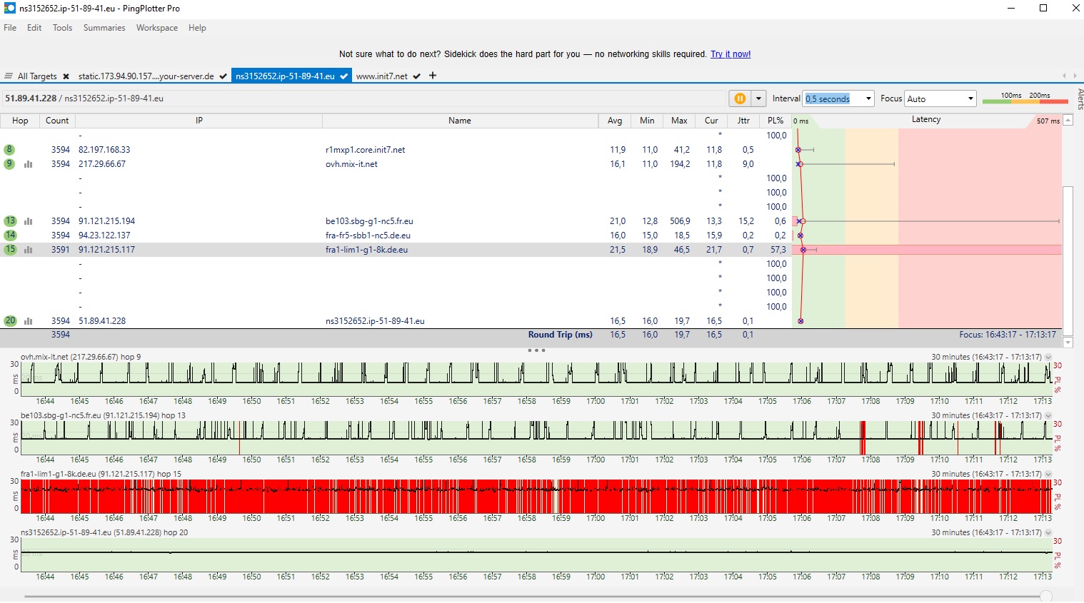

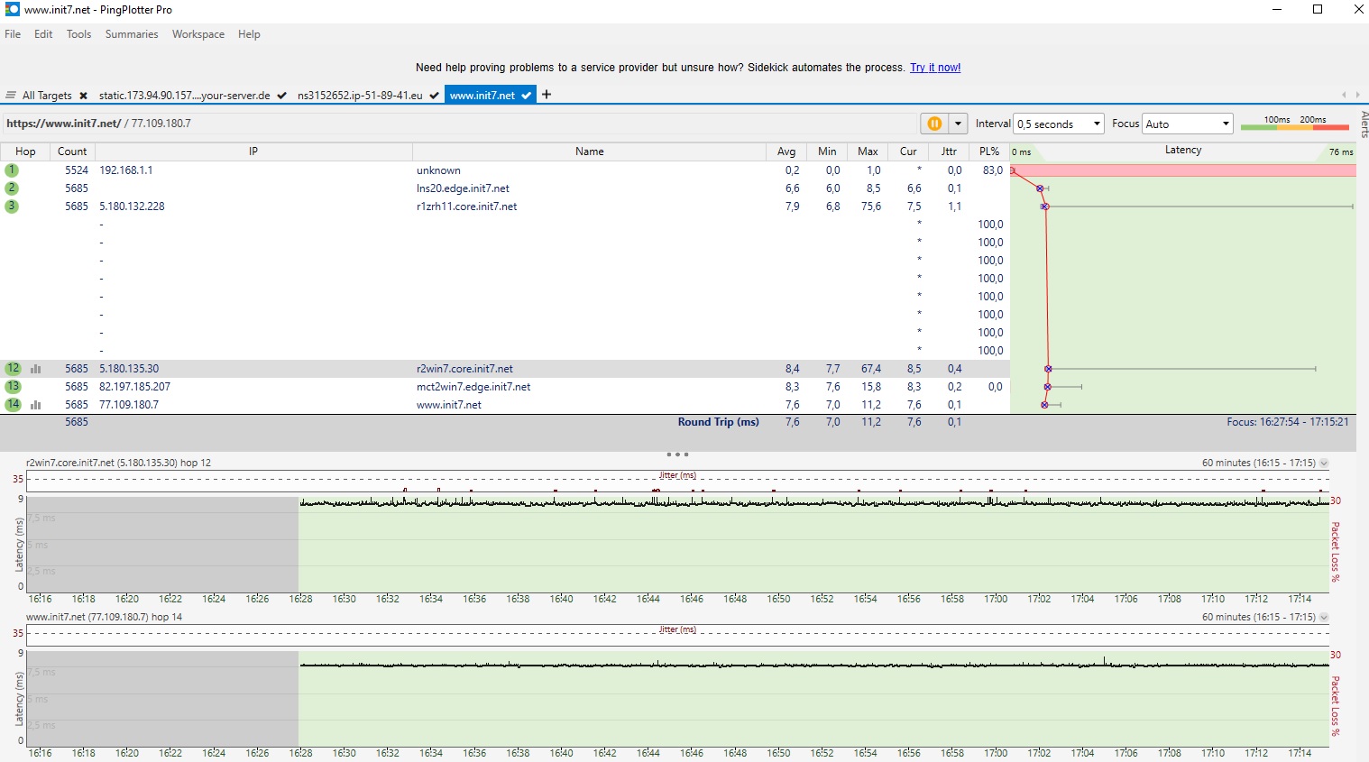

I did some more tests seems, inside company Network it seems fine:
But then when i Ping a Faceitserver shit gets wild:
