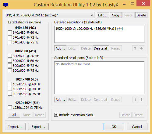

So I have both the 2411Z and the Asus 248.
I just got the BenQ and hooked it up tonight and Strobelight stopped loading. Looks like the monitor was still strobing so i ignored that.
Moving on to the BenQ monitor. I can't get the ghosting to stop on the motion test. It's a good quarter inch behind the actual image when running the 960 test.
Steps taken:
Unplugged the Asus as the Strobelight utility wouldn't run anymore with the BenQ plugged up.
Installed BenQ utility.
Configured blur reduction to "ON" on the monitor.
Slid the sliders both all the way to 0 on persistence/crosstalk.
Set a custom resolution of 1920x1080 with all suggested settings
custom rez.png (24.94 KiB) Viewed 9726 times
custom rez 01.png (16.09 KiB) Viewed 9725 times
Rebooted and then used the "Restart" utility since i'm on Windows 8.1.
The blur test runs at 60FPS and I can't confirm if I'm running at 120hz with reduction via the test. As a basic confirmation, text looks HORRIBLE when I scroll a webpage when comparing to the Asus.
Going to try a few more random ideas, but does anybody else have any good pointers?

If you're using internet explorer, IE can NOT run at 120 fps. You need a different browser to get that working.
It works at 100 hz, though. So just add a 100 hz resolution with a vertical total of 1350 (1502 is better, but you may need to use the toastyX amd/Nvidia pixel clock patcher for high vertical totals). Use total 2080 for horizontal and 1502 for vertical and 100hz.
Using a 1502 vertical total accelerates the scanout enough to make the crosstalk boundaries (strobe artifacts) look almost identical to lightboost (which has its own accelerated scanout). 1503 won't work; the screen will blank. You can use 1502 VT at 120hz also but you WILL need the pixel clock patcher. 100hz may also need it, although I'm not sure; it will need it if the default horizontal total is 2200 (its 2200 on the 27" monitors and usually 2080 on the 24"'s).

Yeah i'm in chrome. It works fine, 100%, no questsions on the Asus. These BenQ's seem a little more finicky.
Testing the 1502 now.

Here's a new issue. When I don't do a custom resolution, the monitor reports that it is running at 1920x1080 @ 120.
Once I do a custom resolution, reboot, and then do the reset64 (windows 8.1), it says it's running at 60hz.
I need to figure out why that's bugging and running at 60hz instead of 120 (altho, the alien invasion seems to say it's at 120hz, AMD says it's at 120hz and windows says it's at 120hz).
I don't know if it's not reporting right on the monitor or in windows.
Sigh, so much effort...

The vertical total changes put the monitor out of specifications. If you read strobemaster's page, he mentions that the monitor runs at a 60 hz backlight (voltage) timing (or something along that effect) instead of a 120hz timing, so the monitor reports 60 hz.
nvm: found the explanation: (vertical lines=vertical total/tweak)
http://display-corner.epfl.ch/index.php ... g_behavior
"As mentioned above, the monitor timing can be tweaked in order to speed up the update process of the LC panel. This is done by virtually making the vertical synchronization phase longer while preserving the vertical refresh rate, as described in the guide to the aforementioned BlurBuster's Strobe Utility. For 120 Hz, the maximal possible total number of vertical lines is 1350, for 100 Hz it is 1500 (empirical findings). These timing modes push the limits regarding pixel clock frequency and it might be worthwhile reducing the total number of pixel columns from 2080 to 2020 in order to lower the line and pixel clock frequencies. Depending on the graphics card it might be necessary to use different sync polarities and within-sync timing values (back porch, front porch, sync duration) in order to make the monitor accept the unconventional timing. It is not fully clear yet, whether at all or in how far the image quality depends on the sync timings. It should be noted though, that whenever the monitor timing deviates too much from any standard timing – which is clearly the case for the timings mentioned here –, the monitor adopts the 60 Hz backlight pulse widths. This is somewhat problematic as it allows to choose pulse durations which could shorten the lifetime of the LEDs. At 120 Hz, for example, the pulse width can be set to 5 ms, which is the intended maximum for 60 Hz though and, thus, pushes the average LED current at 120 Hz way beyond the limit considered safe by the manufacturer. Moreover, the tweaked monitor timings might not work at all (i.e., black screen) if the value for the pulse phase is too high. So, know what you are doing!
