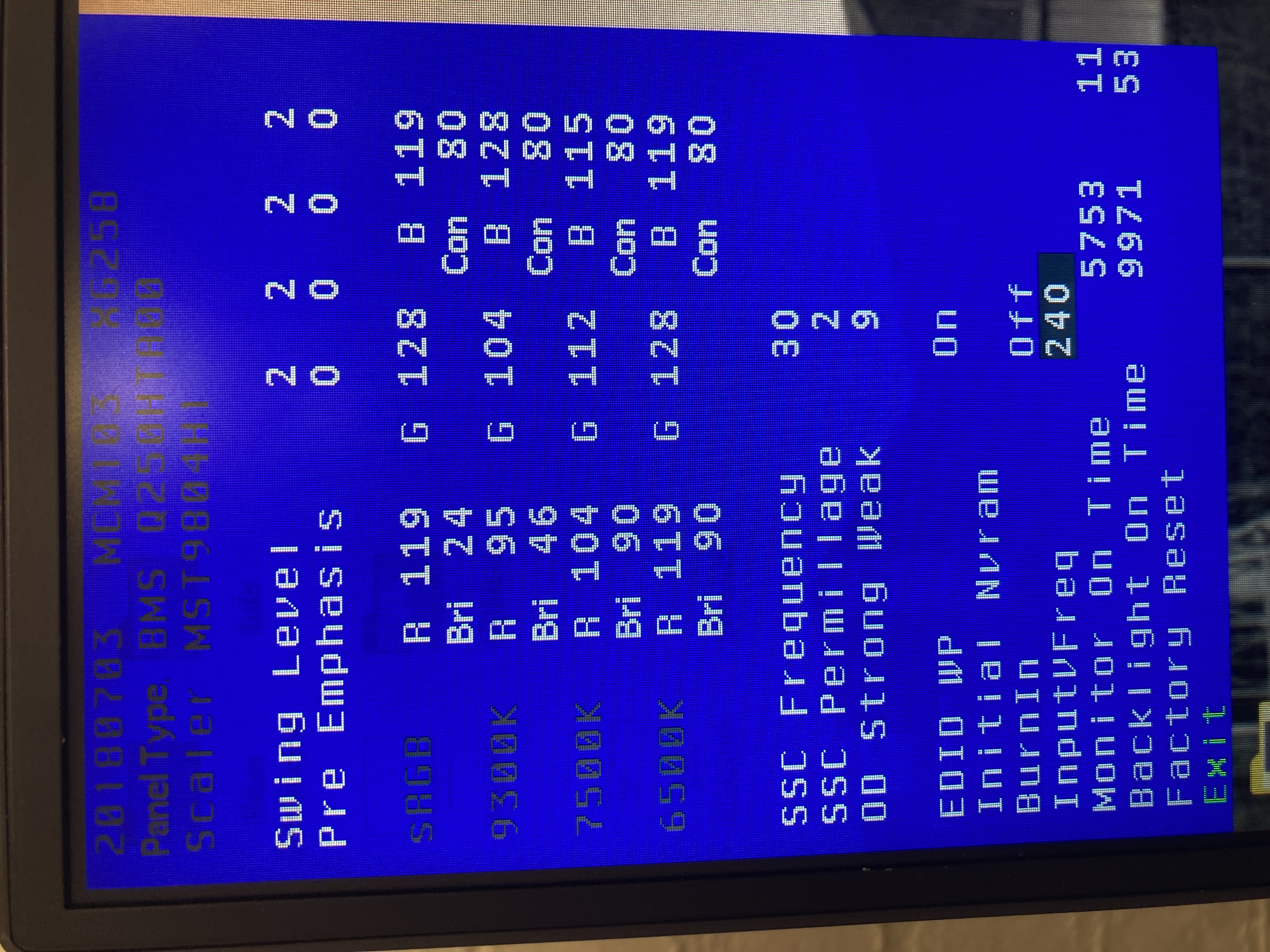

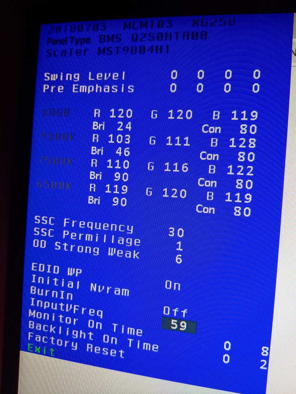

XG258Q Factory Settings
Find attached my factory settings. Thanks for the info on the F. You learn something new each day.
Re: Asus ROG XG258Q owners please help
Posted: 15 Jan 2023, 16:43
by drewdrew
Boanerges wrote:
15 Jan 2023, 00:22
IMG_0507.JPGFind attached my factory settings. Thanks for the info on the F. You learn something new each day.
thank you very much bro, you are my savior!! :)

Damn it. I wish I'd have known that the settings stick even after a factory reset from within that menu. I just learned about this F menu and accidentally altered random RGB values (quite easy to do if it's your first time navigating.), but assumed they'd reset, so I wasn't fussed at the time. A lot of mine are different. Pretty sure I didn't accidentally change so many...
You said you needed sRGB values, yet most of your other stuff doesn't match up either. Does each monitor have different factory values?
I ended up having to copy those provided as I have absolutely no idea which I accidentally changed.
Mine is a 20170730 MCM101 though. Whatever that is.
Edit: Does it even work? I set the brightness of sRBG to 100 in the F menu as a test. When I switch to GameVisual>SRGB Mode the brightness is of course greyed out, but is shown at 19. :?:
Edit: It does I guess. Just not brightness? I reduced red all the way down and that sticks in GameVisual>SRGB Mode.
Grrr so annoyed with myself. I swear the colours don't look right now.
For the hell of it I've attached my settings I potentially screwed up
