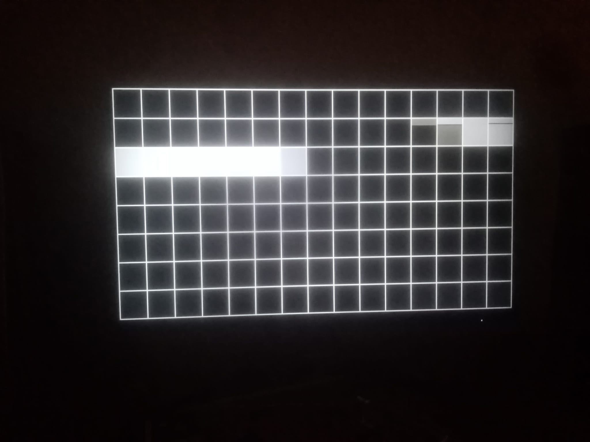

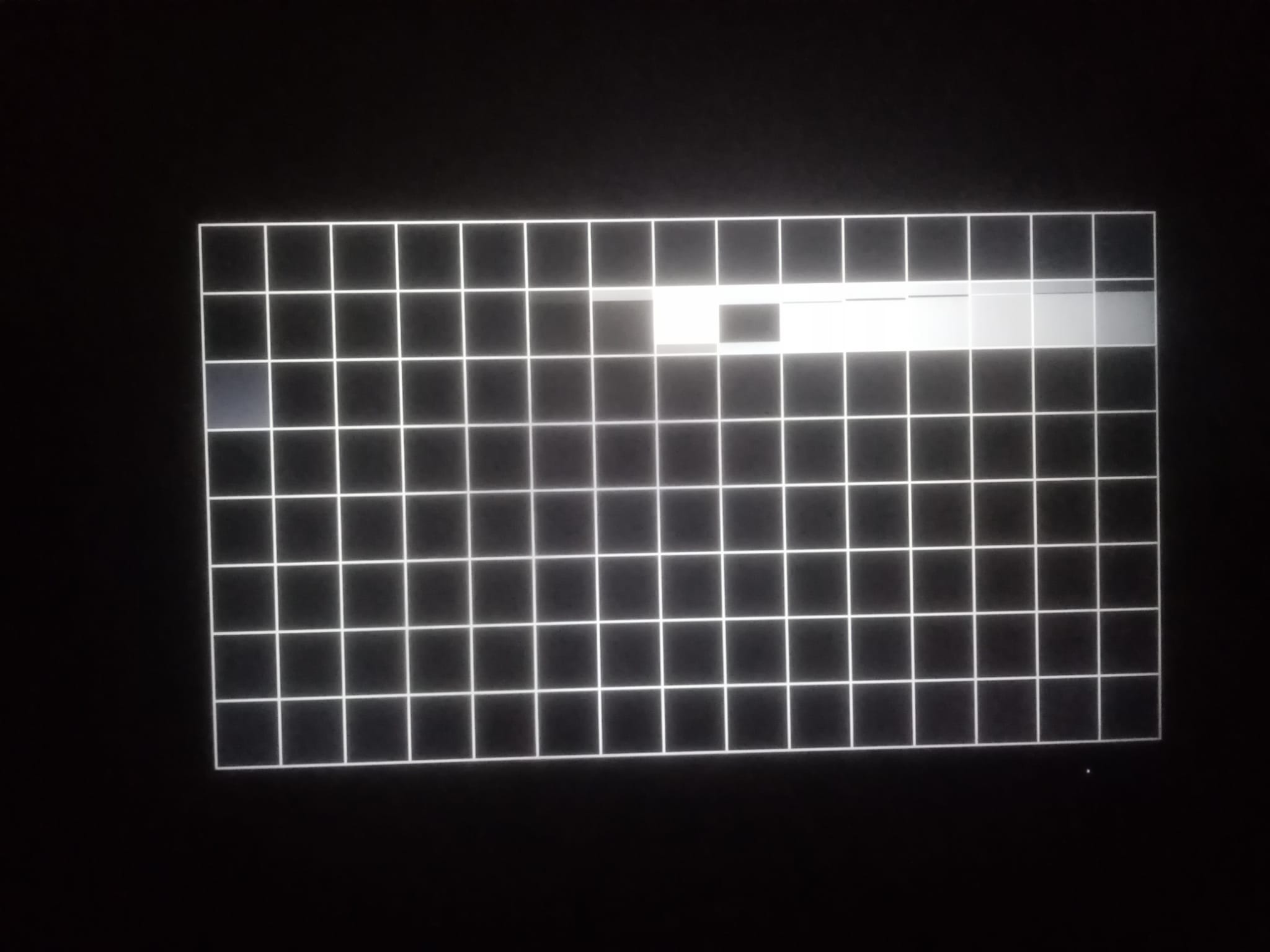

I tought I checked for frameskipping , but I didnt capture the pic while moving squares were on top ( where problem exist) so I did that here it is
It only happens on 2nd column
WhatsApp Image 2023-04-15 at 03.20.48.jpeg (110 KiB) Viewed 9647 times
