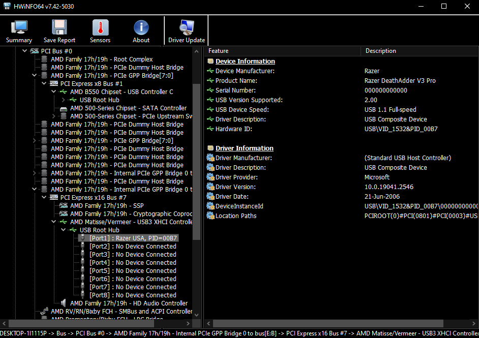

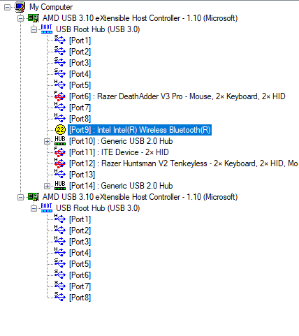

Hey there,
I'm a pro VALORANT player and been into these things since way back, figuring out different things from time to time, came across the USB Ports could be causing slight input lag as it takes more time to transmit and receive when it's connected to the chipset's controller rather than the CPU's, my motherboard says
CPU:
3 x USB 3.2 Gen 1 ports on the back panel
1 x USB 3.2 Gen 2 Type-A port (red) on the back panel
Chipset:
1 x USB Type-C™ port on the back panel, with USB 3.2 Gen 2 support
2 x USB 3.2 Gen 1 ports available through the internal USB header
2 x USB 2.0/1.1 ports on the back panel
Chipset+2 USB 2.0 Hubs:
8 x USB 2.0/1.1 ports (4 ports on the back panel, 4 ports available through the internal USB headers)
there are many of them which are the same, so I had to use USB Device Tree Viewer to figure out, Now I want to know which CPU controller is which, the top one or the lower one, I assume its the top cuz it has the prioritized PCI Busing which is Number 1, while the other one is PCI Bus 7

You can easily verify the port by going into hwinfo main window→bus→check which controller is which; with Zen it will show the CPU and chipset controllers separately.
espresso
Posts: 63
Joined: 11 Feb 2022, 04:56
Re: Couldn't find out which USB ports are the CPUs & which are the Chipset's
Post by espresso » 15 Apr 2023, 13:33
Calypto wrote:
15 Apr 2023, 12:29
And then how would you know which port is which on the back of the MB?
Calypto
Posts: 17
Joined: 16 Sep 2019, 20:58
Post by Calypto » 15 Apr 2023, 15:14
Trial and error.
