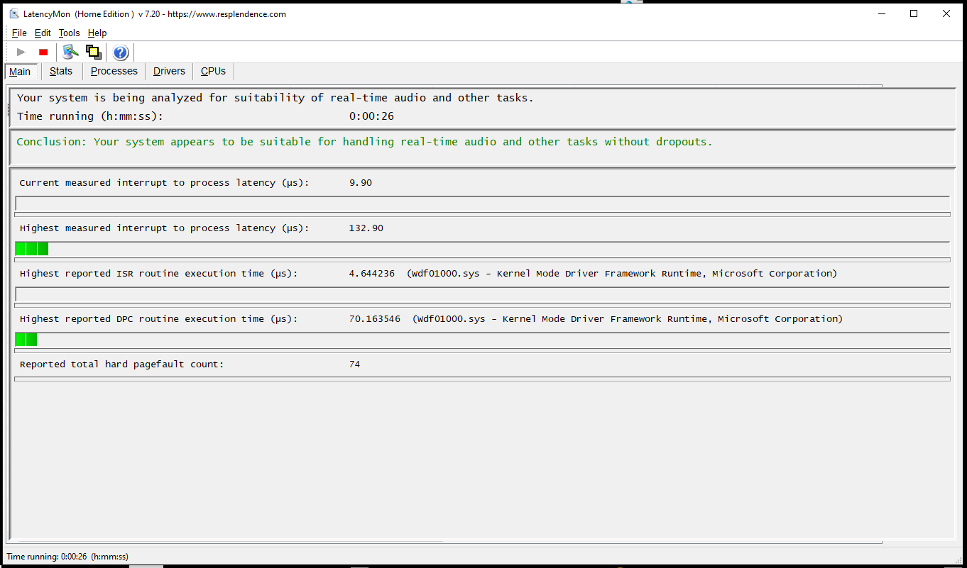

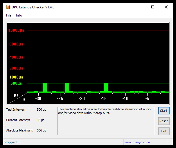

Disable e-cores in bios cause high DPC/ISR usb controller
Posts: 1845
Post by Slender » 16 Apr 2023, 12:45
How to fix it?
simple for 13700k
use bcdedit /set numproc 8 (if you dont use HT) 16 (if you use HT)
Enable all e-cores in bios
all e-cores disable in bios1.png (40 KiB) Viewed 6208 times
all e-cores disable in bios.PNG (13.75 KiB) Viewed 6208 times

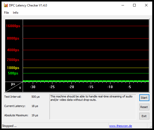

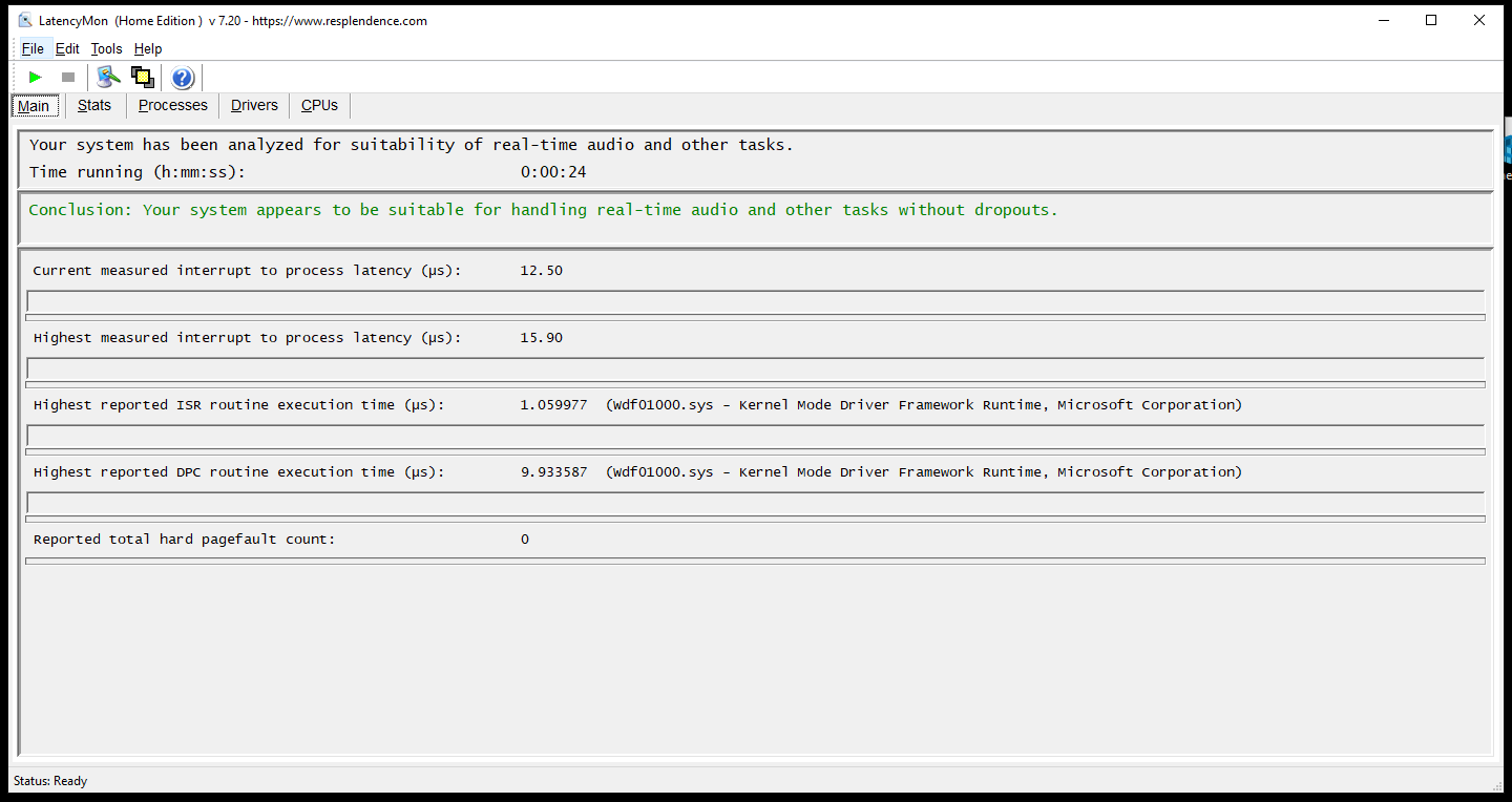

Posts: 1845
Re: Disable e-cores in bios cause high DPC/ISR usb controller
Enable in bios / disable in OS
all e-cores enable in bios disable in os1.PNG (13.16 KiB) Viewed 6206 times
all e-cores enable in bios disable in os .png (37.61 KiB) Viewed 6206 times
