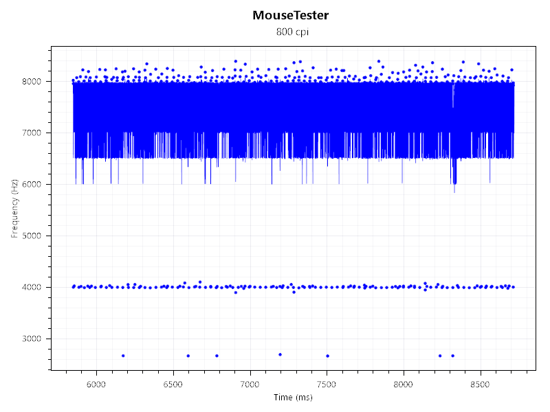

I bought a hyperx pulsefire haste 2, it's the best mouse I've ever had, but has the same problems as the viper 8k. At 8000hz the game looks super smooth (xl2566k), but it feels like the mouse is stuck, like I need to put in more effort than at 1000hz and the line is unstable.
mobo/cpu : msi z790 edge d4 / i7-13700kf (configured bios), GGOS / ReviOS
Also, im try internal usb 2.0 Gl usb chip and mcs9990 pcie usb 2.0 card. It feel better then internal GL 3.0 and z790 usb controller but it not fix the problem.

Am actually surprised most of the samples are >7khz tbh. It's quite normal to see many result in these testing tools showing lower than configure poll rate when mouse isn't moving fast. I have haste 2 and also DAv3 wired, but i only ever used them at 2000 max. are you saying you have to move mouse further than normally you would have to? I wonder if the game is skipping some input from the mouse? Have you tried changing the core affinity of the usb controller from default to share across all cpu core? This is just a wild guess on my part btw, like I said I have never used 8000hz.
I would be curious what rawaccel shows on graph

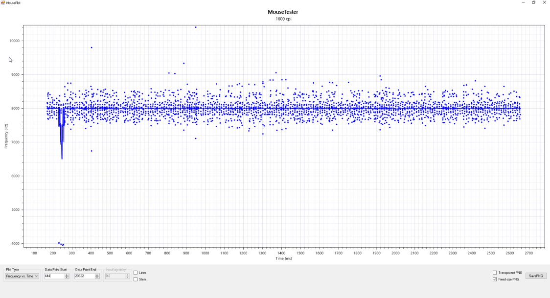

yea, im tried interrupt controller affinity = same.bumbeen wrote: β13 Jun 2023, 07:54Am actually surprised most of the samples are >7khz tbh. It's quite normal to see many result in these testing tools showing lower than configure poll rate when mouse isn't moving fast. I have haste 2 and also DAv3 wired, but i only ever used them at 2000 max. are you saying you have to move mouse further than normally you would have to? I wonder if the game is skipping some input from the mouse? Have you tried changing the core affinity of the usb controller from default to share across all cpu core? This is just a wild guess on my part btw, like I said I have never used 8000hz.
friend with z490 + DA3 8000hz

Now that's very interesting! I wonder if this is so much more consistent because of motion sync? Although I had read somewhere that motionsync only works at 4khz and below, but danged if that line doesn't look real consistent even with the outliers.Slender wrote: β13 Jun 2023, 08:34yea, im tried interrupt controller affinity = same.bumbeen wrote: β13 Jun 2023, 07:54Am actually surprised most of the samples are >7khz tbh. It's quite normal to see many result in these testing tools showing lower than configure poll rate when mouse isn't moving fast. I have haste 2 and also DAv3 wired, but i only ever used them at 2000 max. are you saying you have to move mouse further than normally you would have to? I wonder if the game is skipping some input from the mouse? Have you tried changing the core affinity of the usb controller from default to share across all cpu core? This is just a wild guess on my part btw, like I said I have never used 8000hz.
Since I've got both the haste 2 and the dav3 I will test both on my machine and see what my graphs look like. I am on AMD instead of intel though, B650 mobo and 7800x3d. I'll update this post in I guess 20-30 minutes depending how long it takes me to figure out that mouse tester tool!

thanks for test, but as i can see, you have very high jitter.bumbeen wrote: β13 Jun 2023, 17:38Now that's very interesting! I wonder if this is so much more consistent because of motion sync? Although I had read somewhere that motionsync only works at 4khz and below, but danged if that line doesn't look real consistent even with the outliers.Slender wrote: β13 Jun 2023, 08:34yea, im tried interrupt controller affinity = same.bumbeen wrote: β13 Jun 2023, 07:54Am actually surprised most of the samples are >7khz tbh. It's quite normal to see many result in these testing tools showing lower than configure poll rate when mouse isn't moving fast. I have haste 2 and also DAv3 wired, but i only ever used them at 2000 max. are you saying you have to move mouse further than normally you would have to? I wonder if the game is skipping some input from the mouse? Have you tried changing the core affinity of the usb controller from default to share across all cpu core? This is just a wild guess on my part btw, like I said I have never used 8000hz.

try to stabilize it to 990-1010 on 1000hz.
maybe you use some wrong settings with timers or bios?
