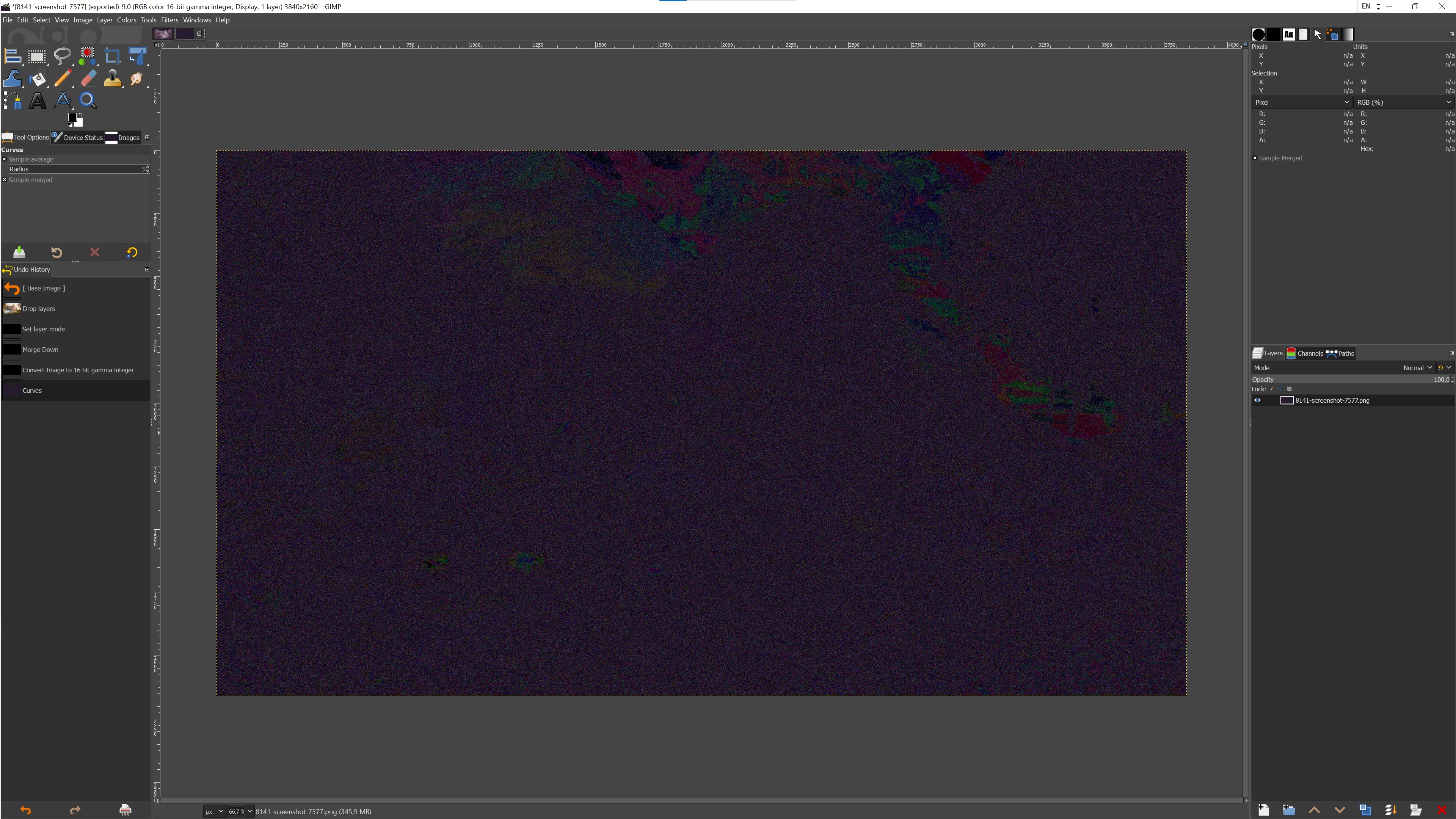

I've attached a sample comparison which one can do in GIMP to better understand which details of image are affected. Notably, I verified that image artifacts described in this review:

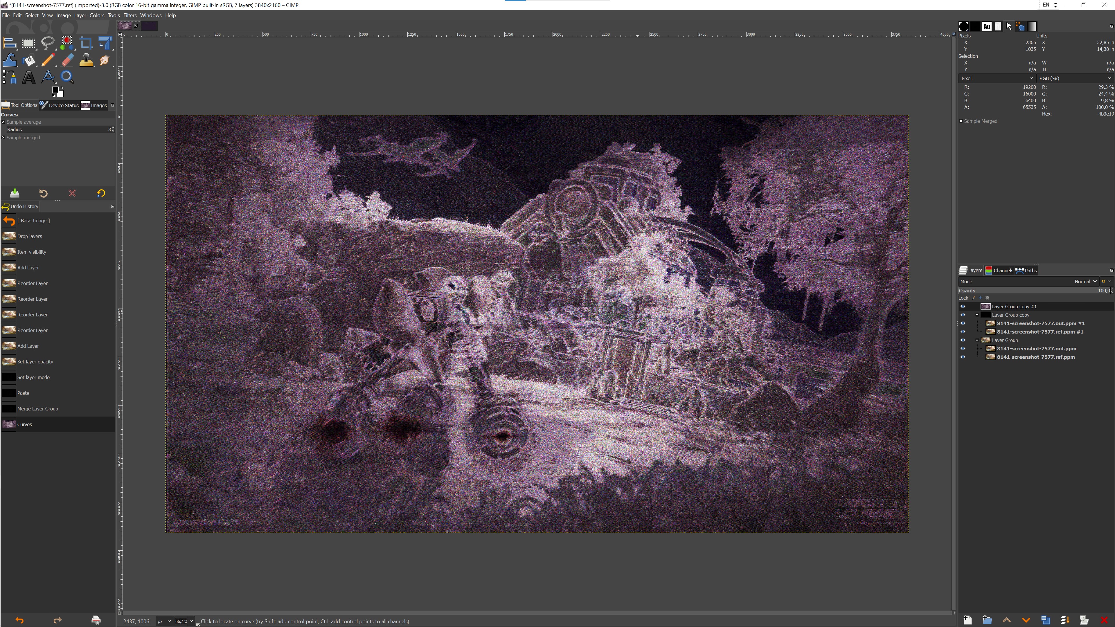

You did not say what compression you wanted to use so I picked worst case - 24 bpp to 6 bpp (4x).
What artifacts do you expect? Some visible patterns of damage? There are none basically, the details are affected but it's hardly perceptible.
Here's quality loss (numerical difference between input and output) magnified by 50x, first in the DSC compression and then in 100% best quality JPEG compression. As you can see JPEG is generally better but affects image differently and yields more errors in the sky.
DSC output is 6,2 MB, JPEG output is 9,9MB.
- DSC.jpg (2.67 MiB) Viewed 50518 times
- JPEG.jpg (2.08 MiB) Viewed 50518 times

Regarding the results, I assume that we are watching the diffs from the original to the compressed one. Given that, the worst case example is clearly a very modified output. I find it interesting that the text is also very modified. Do you know the diff-rate of what is visualized here? Say that a pixel - 128,128,128 [RGB gray] - that is modified by the compression, would that be like 129,130,127 or are we talking bigger offsets?
This is probably asking a lot, but could we get a diff image from the same original image where only 24bpp to 12bpp? I think that would be the most common compression for people out the using this technology.
Sorry for my very delayed response! I have been digging down on a different topic recently.
Thank you for doing the testing, they really put things in perspective.
