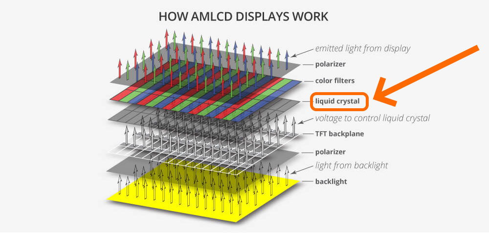

Remember, pressure spots is like pressing a finger on an LCD. You can see how colors/greys distorts. That's because you're pushing a fluid-like substance out of the way. A special liquid of tiny crystals that acts as polarized light valves! That's why the colors tend to distort.

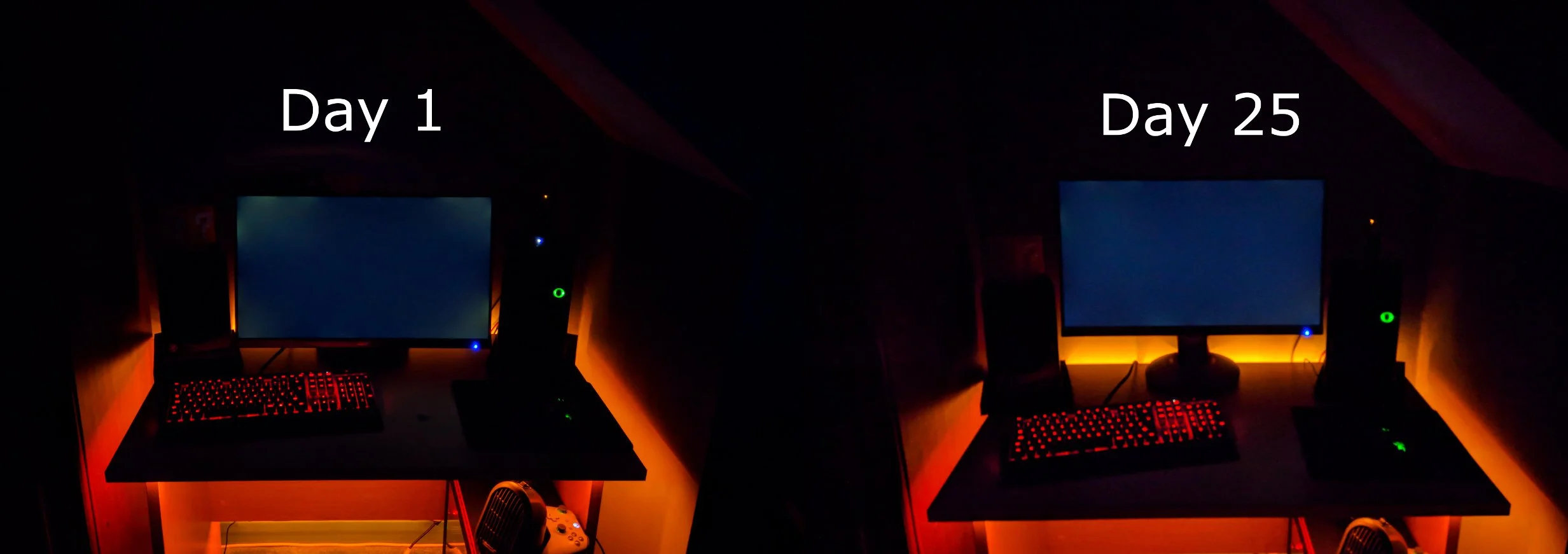

Need proof? A breakin-success image shared on Monitor Enthusiasts Channel on Discord:
(Image from reddit but I have personal experience that improvements happens to more than half of monitors I have)
