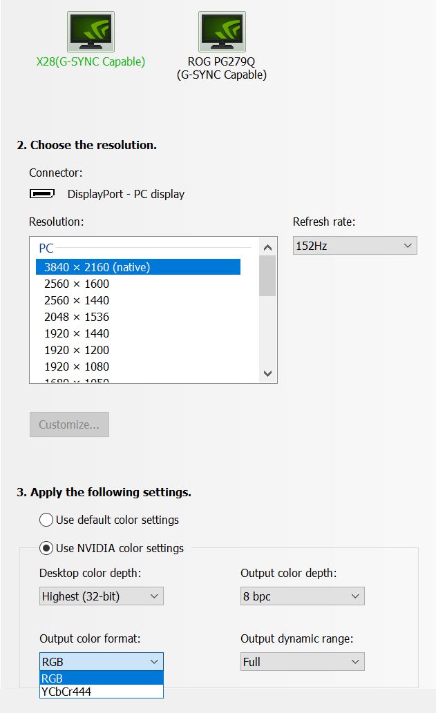

photo 1 is the options under output color format when I am at 144hz 4k. My output color depth options are 8,10 and 12 with a default of 8.
photo 2 are the options I get under output color format when my monitor Overclock is on to 152hz. I only have two options here and the output color depth says the same with 8, 10, 12.

by jorimt
Firebolt059 wrote:
30 Aug 2023, 11:36
Okay, then both scenarios appear to be using DSC.
To fully confirm, view this image at 100% size (don't scale it, or it won't work). If the lower text is perfectly clear and there's no artifacts as seen in the examples on the below page, then it's using DSC to achieve 4:4:4 chroma:
https://www.rtings.com/tv/learn/chroma-subsampling
If so, lower your refresh rate to 144Hz and your color format to YCbCr422. If you still get the black screen issues, then it's probably not related to DSC, and you can continue to troubleshoot other causes.

by Firebolt059
That is an awesome find!!!!
Yes if I use RGB or YCbCr444 in either 144hz or 152hz it looks fine and it must be using DSC like you said.
Swapping to YCbCr422 gives artefacts and the picture is not as clear, which I assume it's not using DSC also like you said.
I'll keep on YCbCr422 to see if it helps.
You are awesome!!!!!
