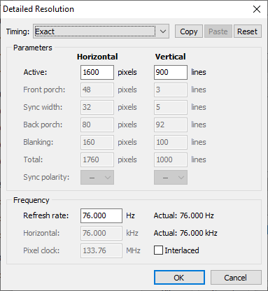

https://www.monitortests.com/blog/timin ... explained/
  • Front porch, also known as sync offset, is basically padding before the sync pulse.
  • Sync width is the duration of the sync pulse. The sync pulse marks the start of the next line (horizontal sync) and the next frame (vertical sync).
  • Sync polarity is whether the sync pulse voltage goes up (+) or down (−). Most monitors can handle both.
  • Back porch is basically padding after the sync pulse, before the start of the active pixels.
  • Total is the total number of pixels including blanking.
Sounds like porches should be lowest (what good is padding?), but width sounds more important to be lowest (more padding but quicker).
1600x900@76Hz Native (PC) does 24/96 front/back porch and 80 width, while Exact does 48/80 32 (higher front porch, way less width); it looks like I'd want Exact timings or any that have the lowest width.
Anything else seemingly doesn't change much and might have minimal effect, but with Total Exact is 1760 vs Native 1800.
