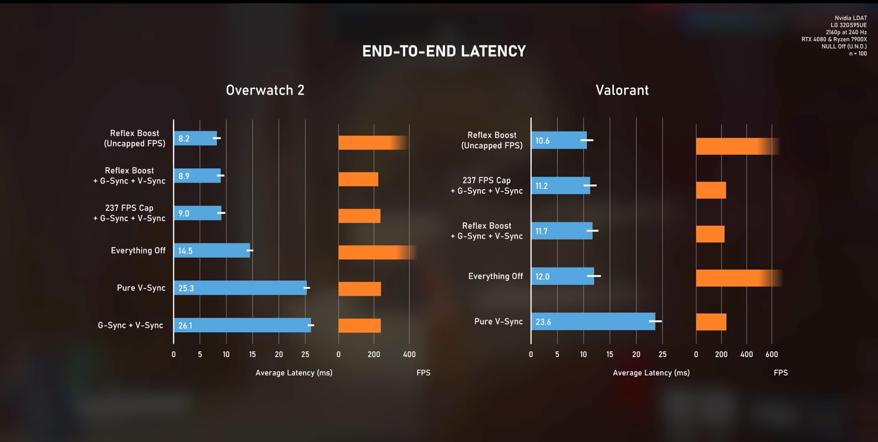

For Nvidia graphics cards:
Using the data given by the video I quoted above, when combining VRR with v-sync (in nvidia control panel), you only need to add 0.3ms of latency for VRR to work correctly. Therefore the FPS caps should be:
240hz = 233fps
165hz = 156fps
144hz = 138fps
120hz = 115fps
Reflex caps fps automatically when used with VRR and v-sync.
AMD graphics cards need 1ms additional time for VRR to work. Therefore the fps caps (if needed) are lower.

Unwinder
- Posts: 10
- Joined: 08 Oct 2020, 06:12
Re: Optimal Freesync Settings?
That's not a source of information, that's a source of misinformation. That 1ms rule is utter nonsense.

- F1zus
- Posts: 198
- Joined: 07 Nov 2022, 17:59
The video card does not need any 1ms. I set amd chill min/max to 236 fps on a 240hz monitor, enable freesync, vsync in the driver and vsync in the game. This gives the smoothest picture possible with low input lag. There are no breaks or stutters. Otherwise, my computer is well configured and there are no stutters with vsync OFF, but there are image tearing.sky_dynasty wrote: ↑13 May 2024, 09:33Today I used G-SYNC Pendulum Demo to test my LG 27GP850-B 165 Hz monitor. My graphics card is AMD 6700 XT.
