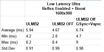

I have spent a bit of time benchmarking the response times of the PG27AQN (latest firmware) using the NVIDIA Reflex Analyzer.
To preform the benchmark I made sure to take into account tick based animations. The monitoring position was located in a bright area and the character was rotated from dark to light using the following bind to do a 180. Also comfirmed with a 480fps camera that the in game pov is rotated 180 degrees in a single frame.
Code: Select all
alias attack_ "yaw 5455 1 1"; bind mouse1 attack_;
Each test was done 110 times.
The most surprising thing that I have found is that ULMB 2 adds roughly 24% of input lag. Is ULMB 2 supposed to add that much input lag?
I have attached an image of the results.
Results
Results

Post by joseph_from_pilsen » 23 Dec 2023, 07:59
ULMB doesnt add so much PERCENT of input lag, it adds a stable +-1.4ms input lag. At worse PC it would be still the same 1ms but 10 percent max... ULMB delay added is just a half a time of monitor refresh (dimming out before every refresh). Mathematically its a half of 1/360Hz interval = 1:360:2 = 1:720 = approx. 1.4ms (your result).
Can you make a test with NVCP gsync on + NVCP vsync on + reflex on? Because this is a setting many people use to prevent 60hz feeling (without vsync the movement persistence is trash).

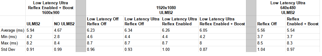

Hi,
That makes sense thanks. I have done the test as requested. Did notice that the game would hover around 340hz/fps instead of 360.
Attached are the results. Let me know if there is anything else you want me to test.

Great job, yes its normal that fps is stable 340then, at 280hz i get 260fps as the drivers do the limit by themselves a bit below refresh rate. You dont need to set any limit manually, the driver overrides it by its own pre-set value. Interesting fact: if you start the game with -vulkan, the driver limit is not being applied and you must use your own or use non-limit values (like vsync fast). But the game with -vulkan runs always a bit worse (at least at nvidia cards).
It also confirms that ULMB/vsync is a good trade-off between responsibility and visibility and motion persistence, for scanning environment for opponents is still critical to have best motion clarity, best persistence and still low input lag. Its nice to have 5ms input lag instead of 8ms but if you dont spot opponent as soon as it appears on your monitor or the game is feeling like 60hz slideshow any time you move your mouse cursor, its a bit useless... I tested all the settings (i have 280hz monitor), vsync off is a big no in cs2, totally unsmooth like 60hz, and ulmb is a bit discutable, OFF is more crisp when the picture is static or when walking slowly, ON is much better when looking anywhere than at my cursor as the background doesnt unsharp + whenever i move faster. The slight delay doesnt matter, the game servers are so trashy that even with ULMB2 is the client ahead from server A LOT (counter step at client = still moving at server etc.).
